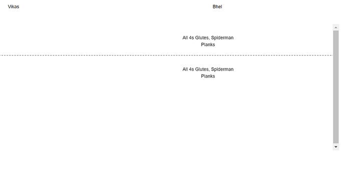

I am creating a page that draws Exercise Names and Exercise Images(gifs) from the database and displays them in a repeated group.
Both these are list fields under the data type ‘Patient’. So they are saved as comma seperated values in the database
The values appear in the same line and not as a list.
So I tried to use extract with regex to get the comma seperated data on different lines.
But the RG goes blank.
How do I get to display the data in different lines? What should be the Regex pattern?

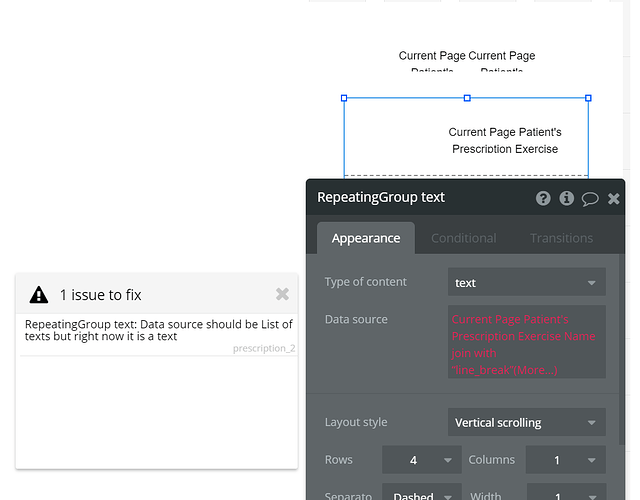

Hi @drswatilimaye :slight_smile: After the list of texts expression, you can use the “:join with” operator and then enter “line break” similar to:
Thank you @fayewatson for your response.
The expression shows an issue with the data type- ‘Patient’ although the field- ’ Prescription Exercise Name’ is a List of texts under ‘Patients’.
How do I correct this?
Regards
Swati
@drswatilimaye Ah! My apologies – when I first looked at your screenshots, I thought that you were putting a list of texts in a text element that was within a repeating group, but now I see that you’re using a repeating group to display the list of exercises with images. That definitely works too! :slight_smile:

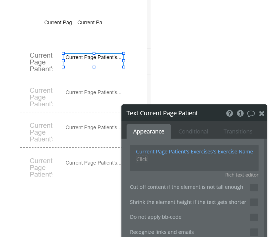

Thanks @fayewatson for the detailed post.
I have a data type called Exercise Bank with fields exercise name and exercise image.
Created a field- ‘Exercises’ under ‘Patients’ with exercise bank as data type.:slightly_smiling_face:
The both the fields now get assigned into the patient’s exercises as suchScreenshot%20(175)
However while I retrive the prescription, the previous issue recurs.
The exercise names get dislpayed on the same line in RG. Also the images are not visible for some reason.
Here is how the dynamic inputs look.
What am I missing here?
Regards
Swati.
@drswatilimaye Awesome! :slight_smile: Since you want to dynamically display the repeating group’s data, use “Current cell’s exercise’s name” for the text element in the repeating group, and “Current cell’s exercise’s image” for the image element in the repeating group. Since your repeating group data source is set to display the Patient’s list of Exercises, you use “Current cell’s…” to display the repeating group’s data (making sure the repeating group’s data source is “Current page Patient’s Exercises”). You’re currently using the page parameter as the data for those two elements, which is why the data each repeating group cell looks the same. Changing to “Current cell’s…” should fix it!
