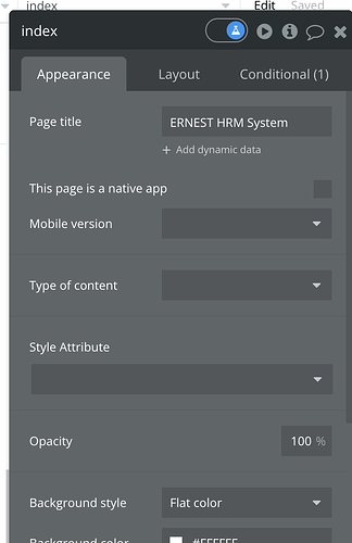

Sure. So the popup where the date/time picker is, this is what it shows. As you can notice, I have set it to static, so all users, regardless of whether they have issues like mine, or if their computers are generating different timezones, would have static timezones for Asia/HK since the Philippines and HK have the same timezone. For now, this may work as all users are based in 1 country.
For the index page, I can’t see an option for timezone.
