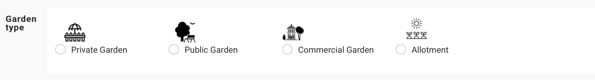

Now all I want is that when a radio button is displayed - next to it, its image as stored in the DB should also be displayed. the Image and Radio button should go hand in hand - in bubble language - should be part of a group. Like this How do you achieve this?!

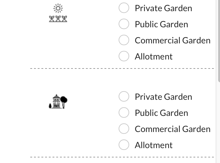

Thank you Boston, If you try to replicate my problem in bubble editor, you will be able to see from my eyes. what I mean is that in the first cell of the Repeating group - there will be an image of first item of the table Garden type - this will be an allotment and the second element will be a radio button type.
Radio buttons expect a list - always. What list will you feed this Radio button? The entire value of Garden Type ? or the First element of garden Type. Either ways we do this, if we follow the repeating group way, each cell’s repeating group will be checked by default and that’s not what we want. This is what we will end up with

I understand what you’re saying. The Radio Buttons element is itself a list, so putting it inside a repeating group (RG) results in a list within a list.

You’re already on the right track to implement something like this, as you’ve created a custom type to be used in a RG. Here’s an example…
And here’s a link to the editor.
Basically, there’s a custom state on the RG to keep track of the current selection. A single workflow on the icon sets the current selection. That’s really it.
EDIT: Oh, and there’s a conditional on the icon to change its appearance when it’s the currently selected one.

Thanks Shot! I jumped with joy reading the first line of your answer! Somebody understood :grinning:Thanks again, I dont know why I couldn’t think of this but its perfect solution. Cheers.
Forgot the radio button element requires a list of things as a data source…must have been why I never use it and do as you suggest with the custom buttons.
