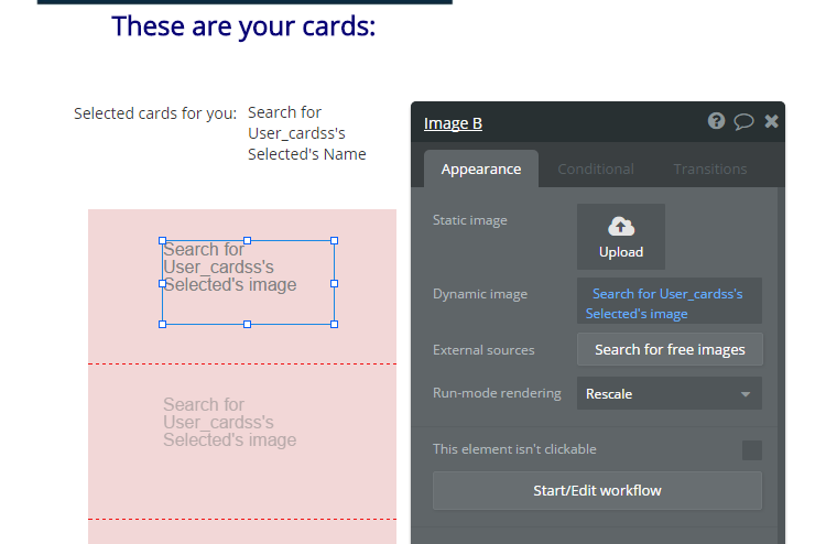

When the user login I wanted him to see the image of those 3 cards using a Repeating group. I search for the current user and then the field where the 3 cards are listed:
ant then I place the images inside the Repeating Group:
But nothing shows up. I think the problem is that the 3 images are in the same row. When I tried the text instead of the images, the name of the 3 cards were in the same first raw of the repeating group. When inspecting the resuts, I can see the 3 images are there:

I think the problem is in your Image B you should set the dynamic image for the current cell’s Image. Since it’s already set with the data source in the repeating group, you should be all set and only need to define what appears not to search for it again inside the repeating group.
Thanks Jhon, it worked just fine!! I spent hours trying to do that and it was so simple. Thanks a lot.
