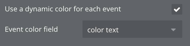

I’m not sure about options here.
in that case in Plan item I have to have field as text. I added color with data type option, but I can’t choose it later in calendar, only text is possible. Or I have to make a switch during API call?..
Screenshot 2023-12-06 at 16.43.01
Thats annoying, not a big fan of pluigins that dont allow for a dynamic expressions.
Seems like you will have to keep a text field on the Plan type.
At this point it might be best to have a text field on the Category type as well. Option sets wouldnt give a big benefit if they cannot be linked. And with option sets you would need to redeploy the app every time you want to change the color. Text field on the database would propagate as soon as you make the change, no need to redeploy.
