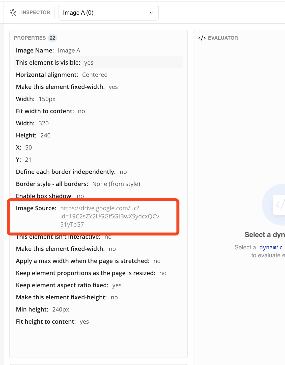

You might be running into a different issue instead. Could you share what your image URLs look like (for example, a sample record from your database)? That’ll help confirm whether it’s a formatting or privacy-related problem.
Also, have you confirmed in Inspect (Beta) that the images have the correct URLs?
