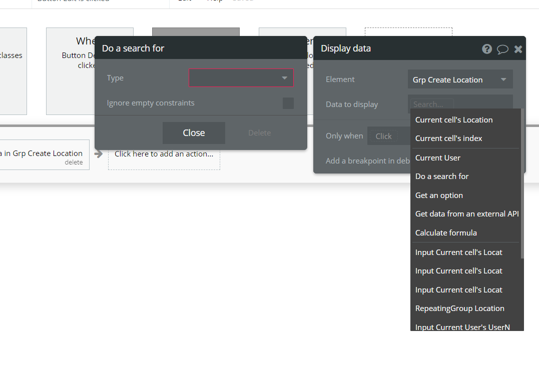

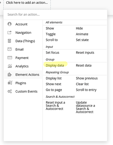

Thanks a bunch. I have put the from in a grp. In the workgrp for the edit button, I select “Display data” as an action picking the form. Thereafter it asks for what data and what I cant figure out is how to push the values from the repeating element to the form. The choices presented are not making sense to me.

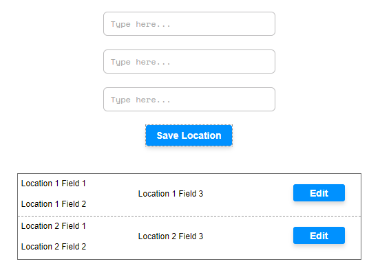

Hi there, @mntcastle… you are definitely on the right track, but this one can be a bit tricky. To elaborate on what Rico wrote, I created an example that is very similar to yours…
location1
As you already know, you need to put the input fields and the save button into a group, and the Type of content for the group should be Location.
As you can see in the screenshot above, you also need to set the initial content of the input fields to show the corresponding values for the Parent group's Location. For example, the setup for first field would look like this…

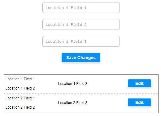

Now, when the Edit button is clicked, you display the Current cell's Location in the group…
location4
So, when I click the Edit button associated with the first location, I get this…
location5
Oh, and to make it clear that the action is different, I changed the label on the Save Location button to Save Changes. That change is easily done through the following condition on the save button…
Finally, you have to make sure the workflow for the save button knows when to create a new thing vs. when to make changes to a thing, and that is handled through the following Only when conditions…

That will send that row’s data to the form group. That’s it!
