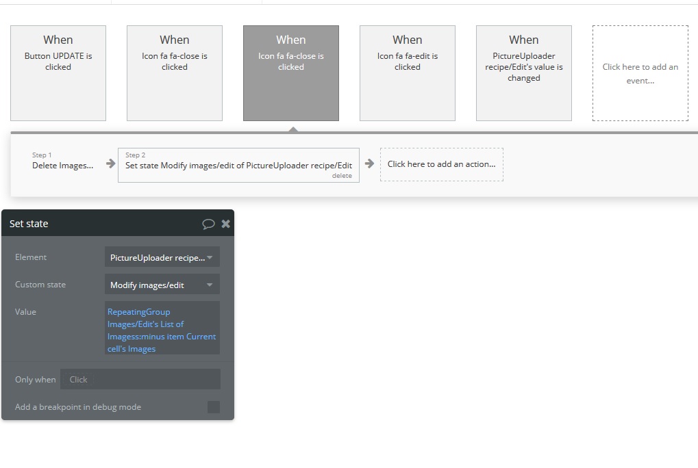

Hi keith , thanks for the reply , actually i think i am using a work flow here to edit the custom state , by adding /delete new images , create new data then set a state , but it looks like i am missing something here , for example the old data not display in the repeating group such as the images i have added when i created the recipe , even if i try to add new images after click on the edit icon , it still not working !!
i have solved the slider issue , what really confused me is that when i try to edit the images in the repeating group , i have done the same steps i did when i try to add new images , i mean if i click on " Add new recipe " i add a new recipe images using my custom state , now if i click on the "Edit button " and try to do the same steps " adding new images using custom state " the images not display on the repeating group !!!
2- i have checked the " enable auto binding " for " MULTI DROP DOWN INGREDIENTS " BUT it didn’t show !!
any help much appreciate
Thanks in advance
when i click on the edit button and try to add new image in the repeating group it works fine , but if i try to remove image deleted from the data but the delete icon still exist and it seems like the RG still count the deleted images as if it still exist !!! even after i click on “UPDATE” button nothing change in the old data !!
when i click on I"Inspect" it show me that image source is empty !! [ ONLY image i added recently "edit " images
any help much appreciated
Thanks in advance
i found the solution in this link : Delete image not disappear from repeating group
