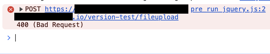

HOWEVER, whenever the file size is >50MB I get the following error in my console:
…and the file does not get uploaded to my database.

Hey there,
Bubble considers files over 50mb “large” files. First of all, you need to have the checkbox “allow uploading of large files” enabled (it’s been some time since I’ve looked at this, but I think it’s at the top of the element tab in the editor).
Second of all, context upload file does not support uploading large files (it’s also not the best method to upload files in general).
You need to use the instance.upload file method:
Have a look at the code in my uploading plugin here to see how I do it: Better Uploader Plugin | Bubble
the method in the context is the normal limited upload, the method in the instance (once you select the large file option) is the one you want to use. You have the inline documentation at the initialize section:

But unfortunately I’m still running into this error in my console:
Can you spot anything else I might be missing?
As per the documentation you need to use a File object, not a Blob
Thanks @dorilama, that set me on the right path and managed to figure it out :slight_smile:
