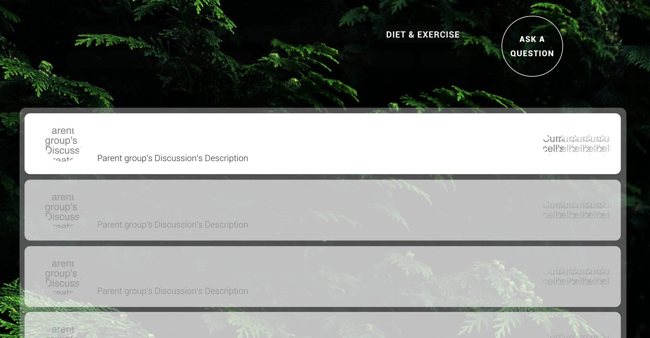

Can I expand the background of a repeating group beyond the edges of its cells? In the attached screengrab I mimicked what this should look like by placing a shape behind the repeating group. (The problem with using a shape is that the repeating group is an infinite scroll, and a shape has a finite length.)
Any ideas for creative solutions much appreciated!!
