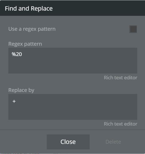

I have an external link linking to Google Maps (app if installed or site if not). It includes the Origin and Destination and tells it to use walking as the mode of travel. It works fine on an Android phone but on an iPhone it adds in a %20 instead of a space in various places. I have tried several ways to replace this including as per image (both with RegEx checked and not)

Try using a find and replace %20 with + and see if that helps. Right now you have %20 with a space. So instead of the space, use a +.
Hope that makes sense. :blush:
A picture is probably better, here you go:
Thanks @J805 I did try that. The problem seems to be that it isn’t recognising the ‘%20’ as in both cases the output didn’t change
Hmm, I keep trying too and it doesn’t like it even when I manually put in the data with that link. Are you sure that is how the link should be formatted?

@J805 has the right idea. They need to be replaced by a +.
I have a small plugin I use to make life easier, but it’s essentially the same thing.

Ah, it’s a private plugin. It’s just more or less an easy way to have a placeholder. Still requires the need to find and replace the spaces with +. I can share it or just make it public.
The link above looks good. Only thing I’m now noticing is @2020travelapp is using the ‘calculate coordinates’. This shouldn’t be necessary as long as your passing the from and to address in the url. Google will automatically format it for you. Next test you run, watch the url bar change. :slight_smile:

Thanks to @lantzgould verifying that this is how it works. I got it working, you can copy and paste from here first to make sure it works. Then insert your dynamic data one piece at a time.
https://www.google.com/maps/dir/?api=1&origin=20+W+34th+St+New+York+NY+10001&destination=200+Central+Park+West+New+York+NY+10024&travelmode=walking
