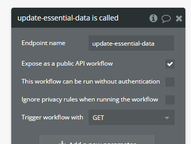

I found the answer.
If you are using a 'Trigger API…" somewhere in your app and using ‘Current Date/Time’ to do it, there is a much faster way. My use case specifically, I’m using it to load data to the user from an API on page load, though I’m sure you could adjust this however you needed with an action.
Doing it how I previously had it setup (above,) I was averaging a wait time of ~12.7 seconds. With the adjustment below, I am only waiting ~2 seconds.
Super easy - just expose the backend API workflow, and trigger the workflow with a GET request. BUT The Bubble API plugin won’t work for some reason to trigger the GET request.
Since I’m calling mine on page load, I just threw it into an iframe’d HTML element and it worked like a charm.
