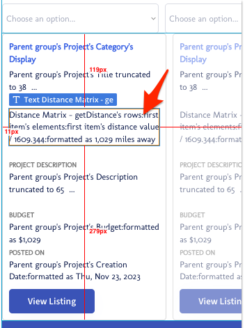

Hi. I would like to use a dropdown menu to filter a repeating group based on a dynamic data point that is calculated per item in the repeating group. Take a look at the image, please. FYI, I know how to do this for the data fields w/in the data type of the repeating group.

What are you trying to filter by? The image doesn’t have any explanation about what it is. Are you trying to filter by the value calculated within the repeating group cell? If so, you can not do that I think since the repeating group is displayed, so then how can it be sorted after displayed based on the calculated value? Also, the sort function only (as far as I know) allows you to sort by fields that are part of the datatype the search is for.

Yes, I am trying to filter by the value that is being calculated (the value being pointed to in the image). And, yes, of course, I am find if a solution is to calculate the value before showing the repeating group. I’m open to any solution.

Additionally, each of the projects in the repeating group has a dynamic data pointthat isn’t saved to the database. This dynamic data point is called ‘Distance From’. Its result is calculated via an API that I send values from the project data type of each project.
My question is, how can I filter the repeating group by the ‘Distance From’ data point?
