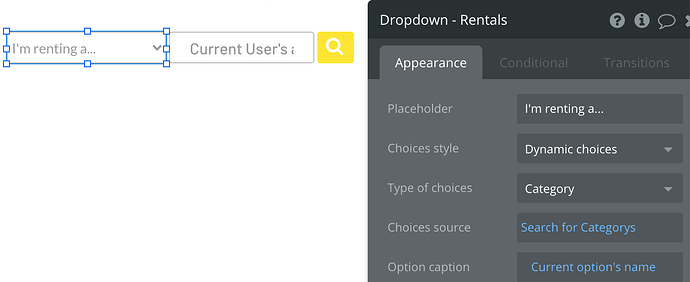

Home Page w/ Category Dropdown:

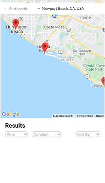

Screen when I send ‘Surfboard’ as retail-item parameter to next page’s dropdown:

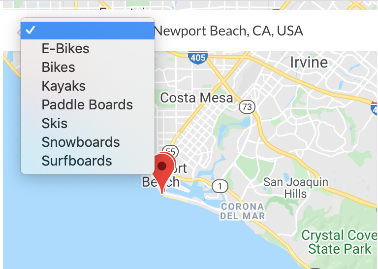

Notice here that when i click on the dropdown, that’s when you see that ‘Surfboard’ isn’t actually associated with the Surfboard Category name, thus causing no search results:

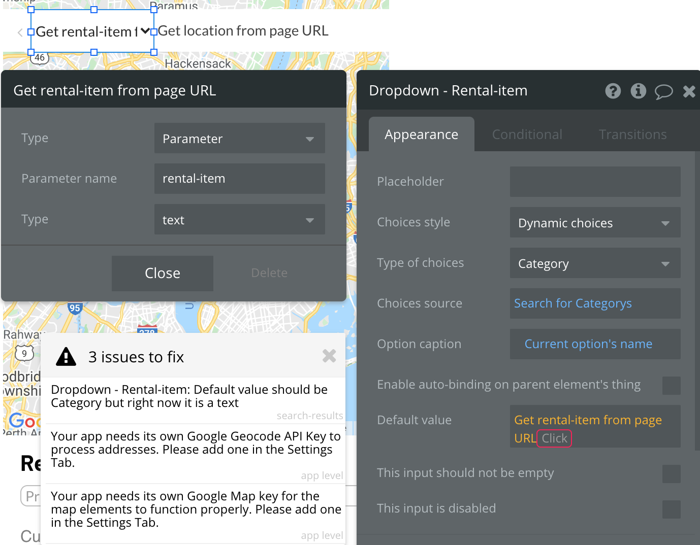

@rpetribu Not sure what i’m doing wrong but the ‘Default Value’ is still asking for a Category type of data/asking for more.
My workflow for sending the parameter ‘rental-item’ to search results page:
Search Page’s dropdown:

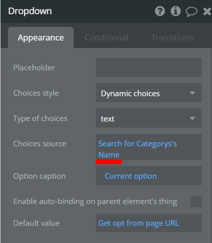

Hummmm… lets see…
Your dropdown (located in your second page) should be like this:
The URL parameter is a TEXT. So your Dropdown must be a list of TEXT and not a list of CATEGORIES.

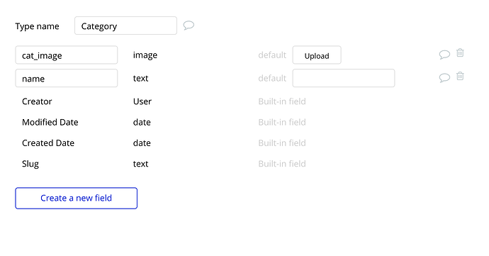

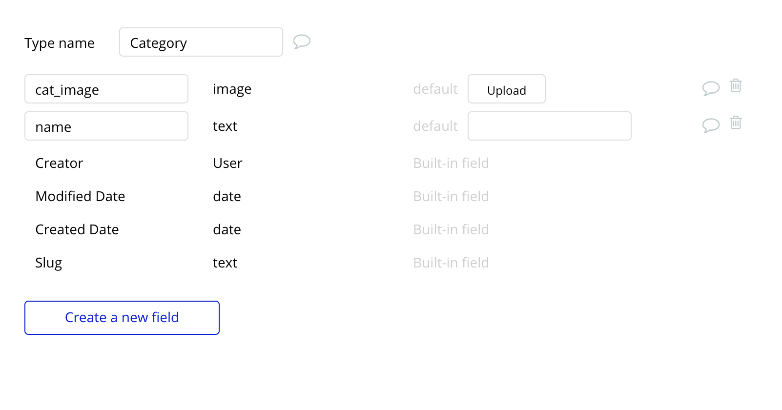

Send me a print of your database Categories
Categories:
Stores:
The Store data type includes a list of categories as you can see
In your dropdown change the “Type of choice” to Text instead Category. :slightly_smiling_face:
