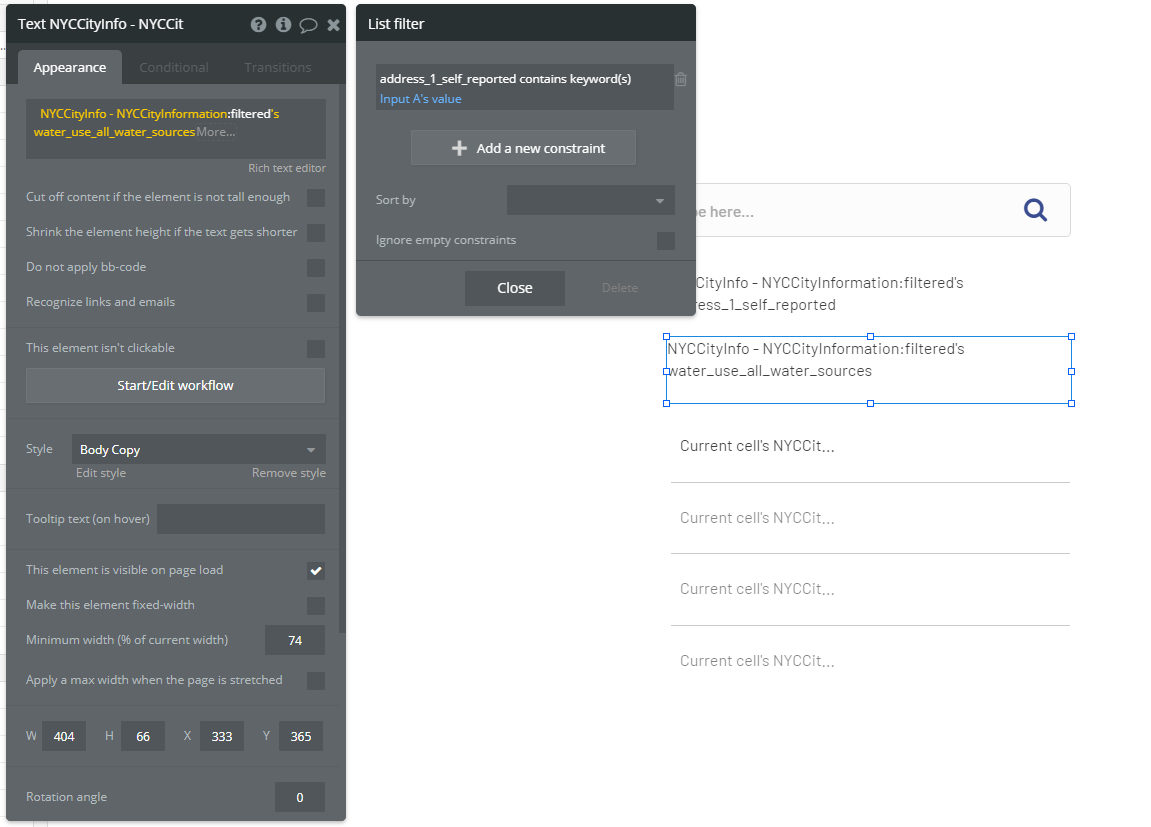

I was able to get all the filtered or searched results inside of Textboxes.
However, is there a way where I can see the result in a form of a list?
this is how I set up the file.
I tried to replicate the same ‘filter’ method for Repeating Group so I can see it in a list
but there was no ‘filter’ method when I click More… for data source.
Any thoughts?
Thank you!
