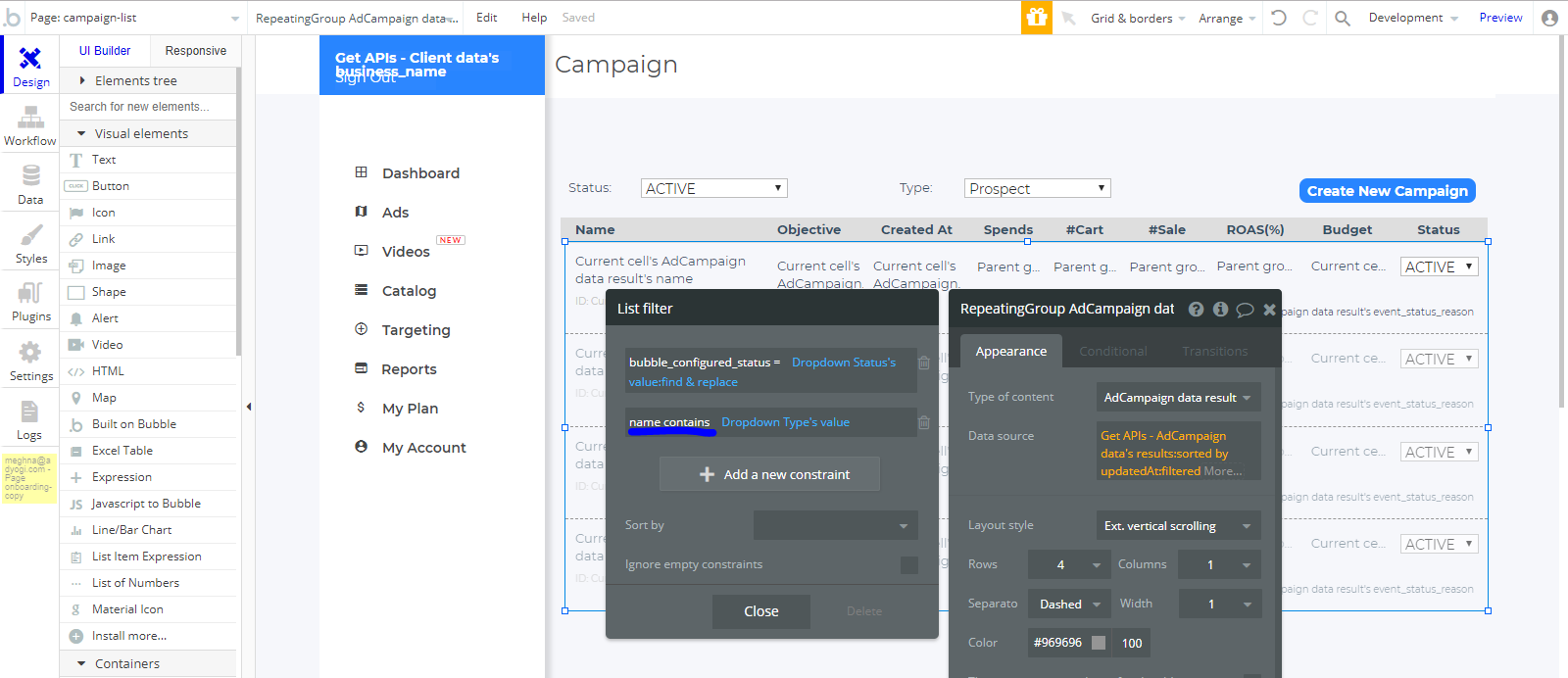

Now when i try to filter by the condition “name contains Prospect”, I am not getting any value in return, the repeating group is turning empty.
Can someone help me with a solution for the same? I am not sure where I am going wrong here!

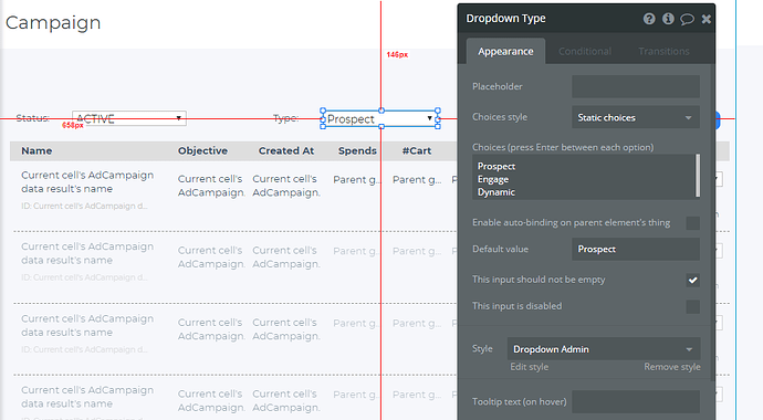

The below mentioned are some screenshots for the same.
  1. Repeating Group Setup
  1. Dropdown Setup
  1. API response
Hope this helps!

Just to double-check, there isn’t an extra space after “Prospect” in the dropdown or in the default value “Prospect”?
If not, if you remove the first constraint temporarily (bubble_configured_status = Dropdown Status’s value:find&replace), do any of the Prospect matches show in the RG? (Just curious since the name constraint part looks correct!)
I tried the same, But there seems to be no space before and after the word.
I even tried to manually enter Prospect instead of Dropdown to test the same despite that i am not getting any values in RG.
Is the name parameter marked as private in the API setup? If so, is there a difference if you uncheck private? (Also not sure if that would make a difference?) I did a forum search and the post below states that Facebook previously prevented filtering on some of their APIs. It looks like all was fixed a while ago though, but it may be worth it to send an email to support just incase?
