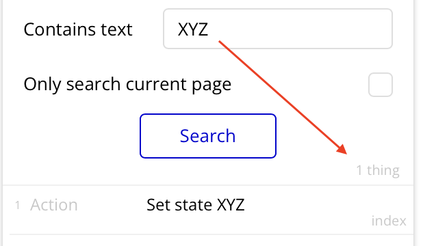

And using “contains text” option you can narrow down the list just to check all actions where your custom state is used:
