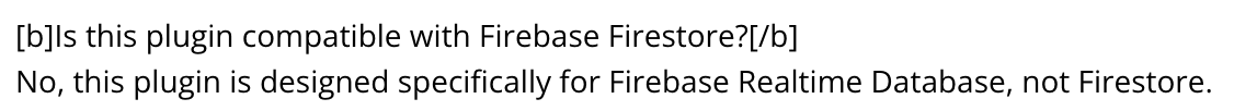

In the official documentation they always refer to the firestore database instead of the realtime database, although on the official plugin page it says
Is this plugin compatible with Firebase Firestore? No, this plugin is designed specifically for Firebase Realtime Database, not Firestore.”
Even in their demo-project they seem to read data from a firestore database and not from a realtime database as far as I can tell. So I am not sure how to access the data with the Get Data action

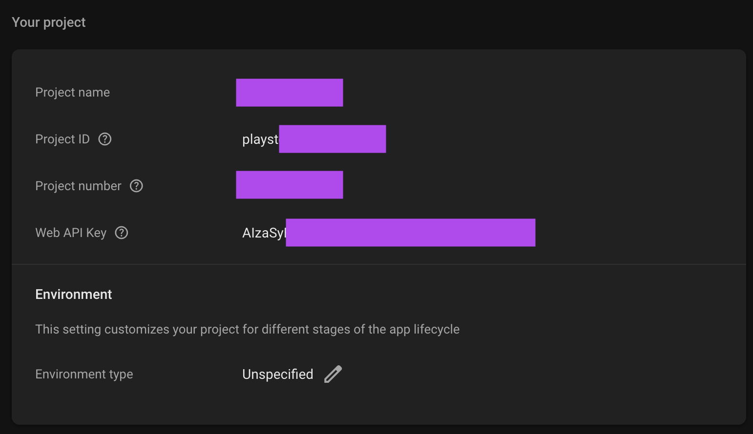

Hi @blindedhalo,
Thanks for providing all the details and screenshots.
It seems like there’s some confusion with the Firebase Realtime Database and Firestore. The Firebase Data Sync plugin is specifically designed for Firebase Realtime Database and not for Firestore, which could be causing the issue since Firestore is often referred to in your setup.
Steps to Access Data Correctly:
  1. Verify the ProjectID:
  • Ensure that the ProjectID you’re using corresponds to the Firebase Realtime Database project.
  • You can find this in your Firebase Console under Project Settings → General → Project ID.

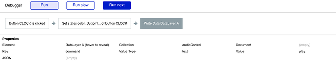

Sure thing. These are the debug screenshots, but so far I do not encounter any error messages.
1. Sender
2. Receiver
Hi @blindedhalo,
Thank you for sharing the debug screenshots. It’s good to know no errors are encountered so far.
Based on the provided details, the workflows for “Sender” and “Receiver” appear to execute without issues, but the desired functionality (monitoring changes and triggering audio play/stop) may not be working as expected.

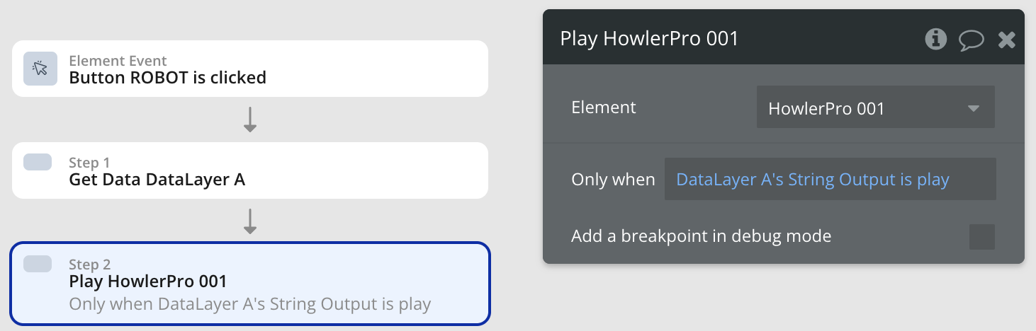

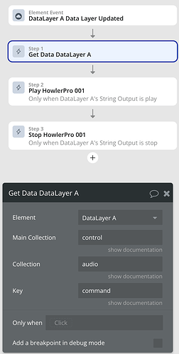

This is my debug setting: Retreiving the database changes with a button click and playing the howler based on the string output of the Data layer. This works all fine.

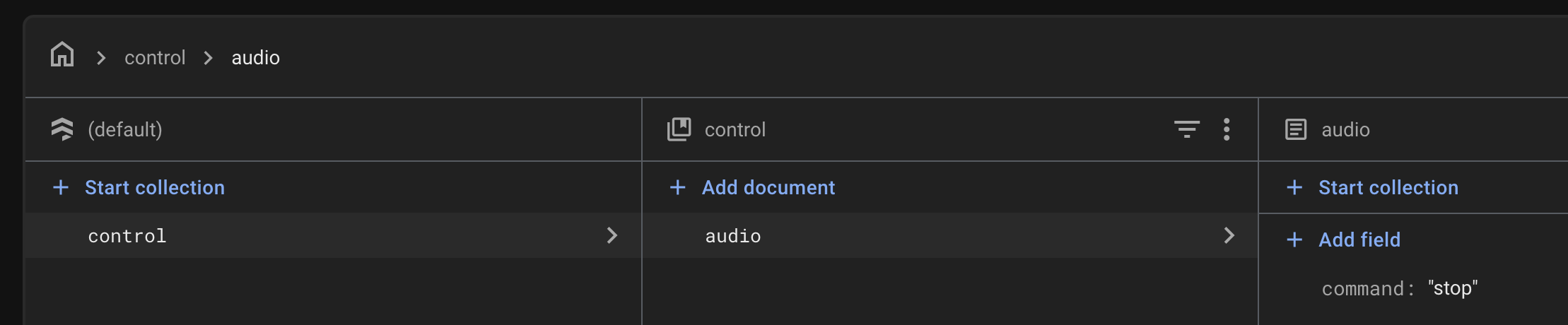

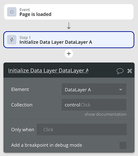

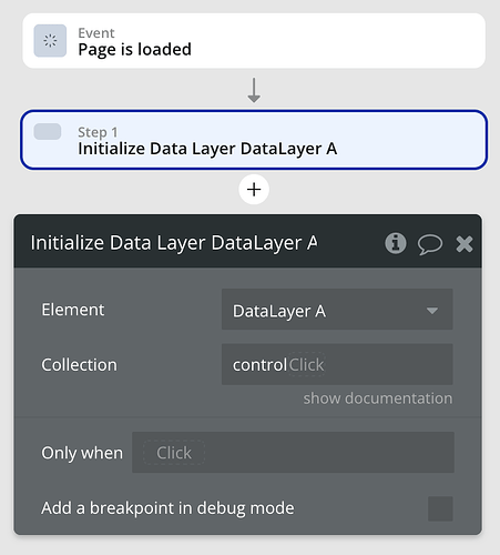

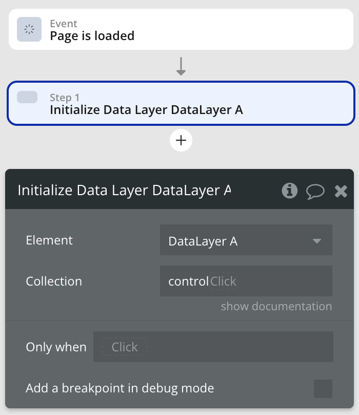

I am not quite sure how the Initialize Data Layer action should be set up in any other way? I set it to “page is loaded” and then put my Initialize Data Layer. How could the “Data Layer Updated” event be triggered in any other way that just setting it up like shown above? (it is an event after all?)

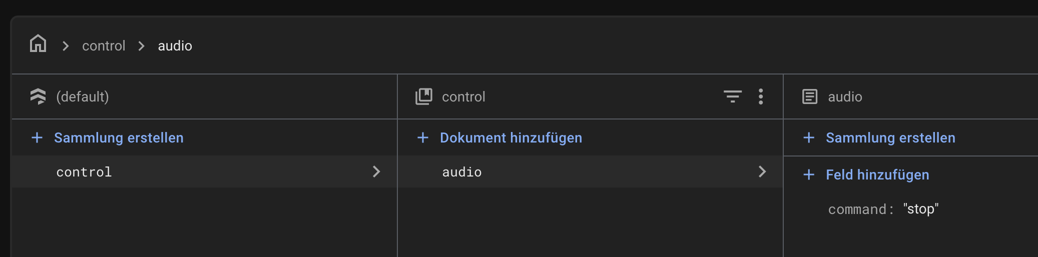

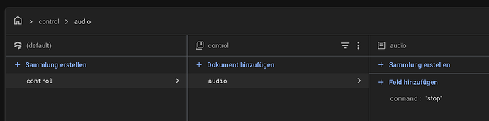

My Firestore database is set up like this, so I use the collection “control” to monitor in my Initialize Data Layer event. So is there any mistake in my collection path?
The page is open and the debug (as mentioned above) is working with a simple “Get Data” action.

Your current setup looks correct in terms of how the Initialize Data Layer action is triggered. The fact that the Get Data action works suggests the Data Layer is indeed initialized. However, to better understand why the “Data Layer Updated” event might not be firing, we’ll need to dig a bit deeper.

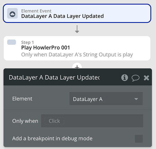

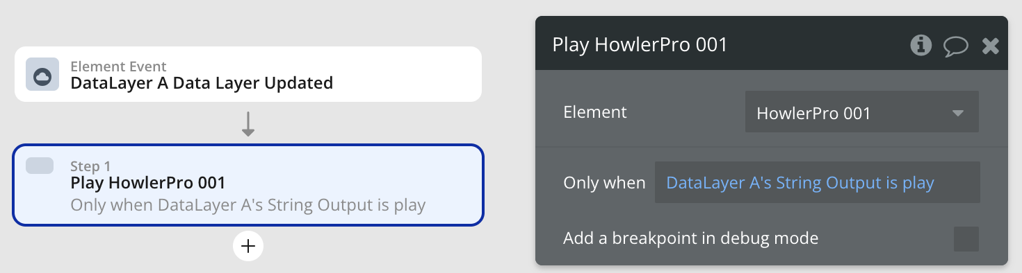

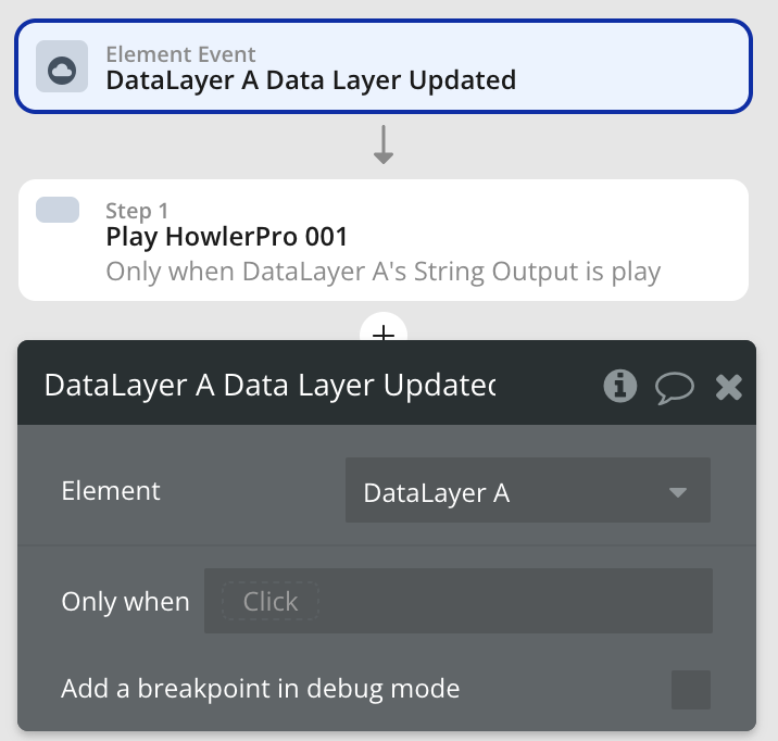

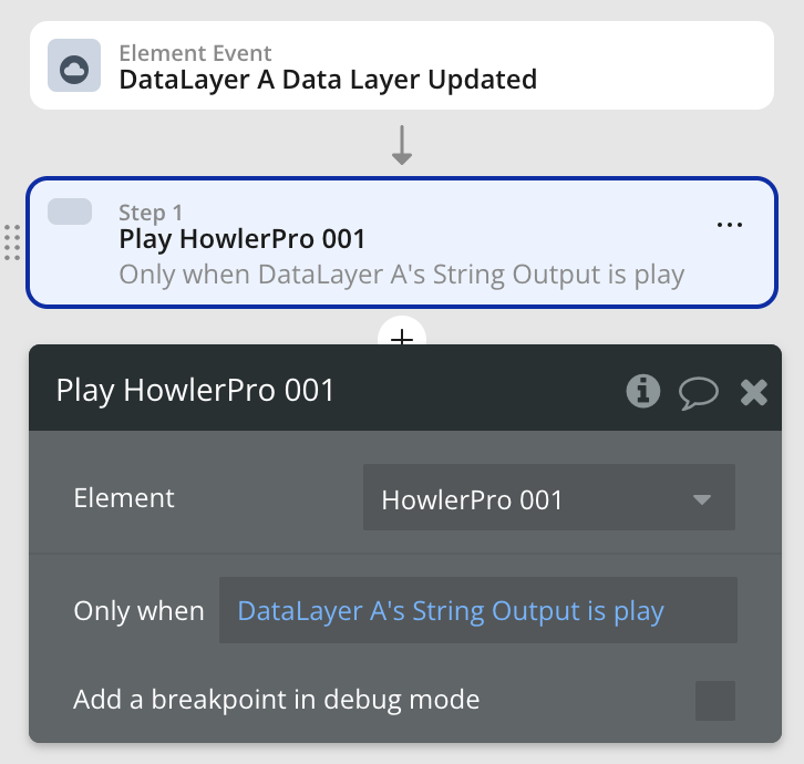

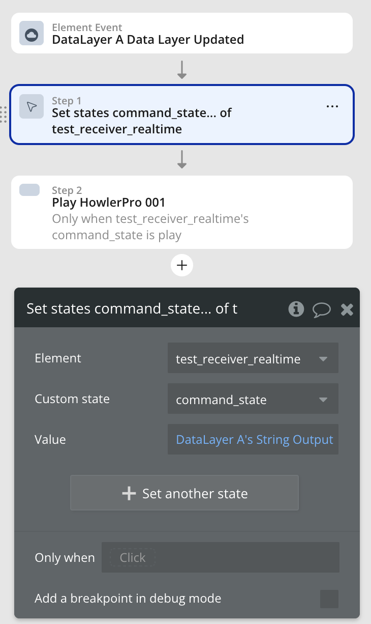

I posted these before, but maybe you missed them (this conversation increasingly seems like talking to an AI bot I must confess…).
This is my setup for the Data Layer Updated event with no conditions attached:
The Firestore Database is being updated while the receiver page is open and the changes are reflected in the database (as seen in the screenshot below):

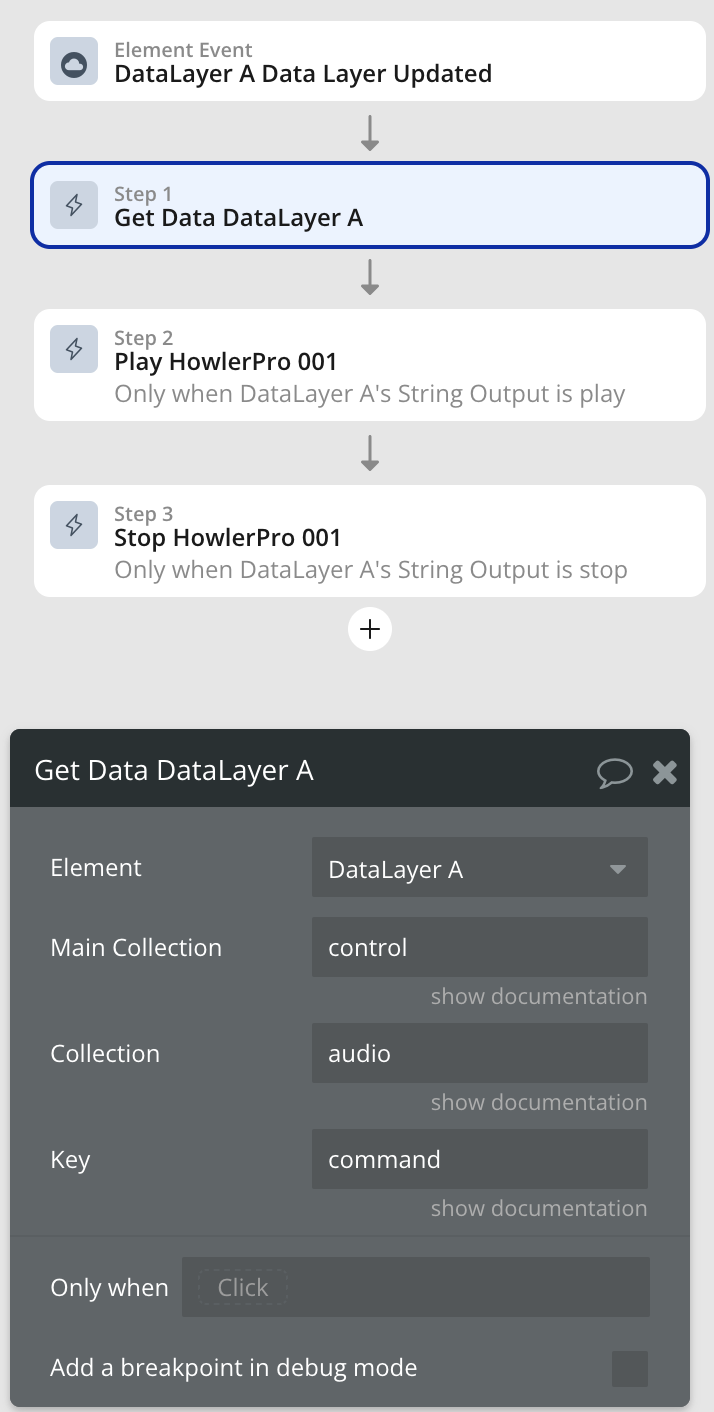

Hi @blindedhalo,
Just a quick update - we’ve released version 1.9.0 of the Firebase DataSync plugin.
This update includes an improvement to the “Get Data” action, which now prevents the “Data Layer Updated” event from triggering when a collection is first initialized.
Please feel free to update to the latest version and let us know if it resolves the issue on your end.

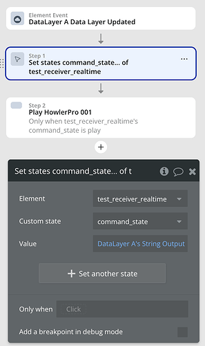

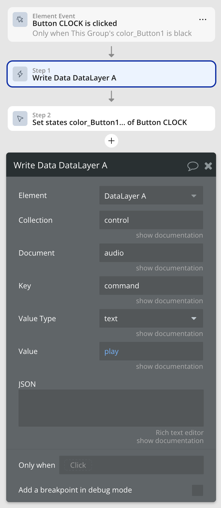

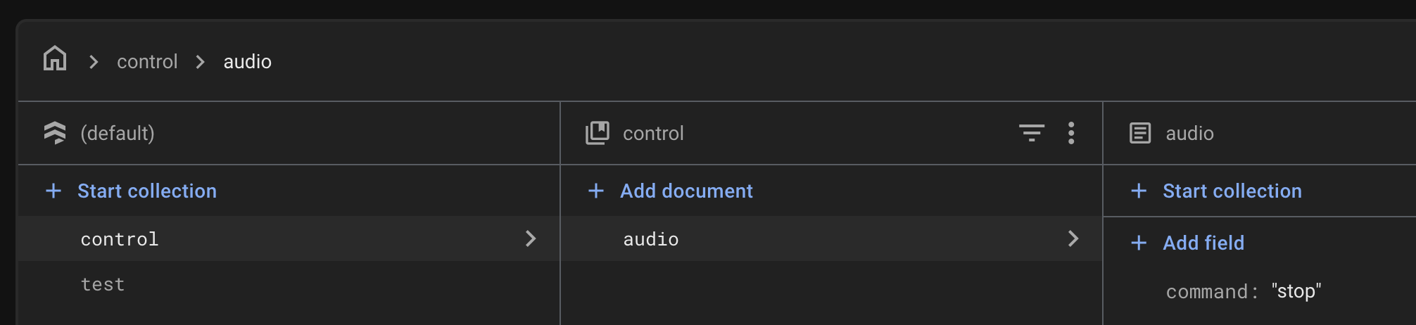

Dear ZeroqodeSupport-Team: YES, indeed now everything works perfectly fine. Thank you so much for the continous support, that was really amazing!
And for everyone reading along. Here is the final setup I used with the Firebase Data Sync Plugin version 1.9.0. I am changing the data in my Firestore Database (important: the plugin only works with the Firestore Database, NOT the Realtime Database!) via a trigger page. The receiver page then reacts to those changes in the database via a Data Layer Updated Event (setup: see pictures below):
Firestore Database setup
TRIGGER page
RECEIVER page

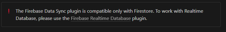

Just wrote a review and wanted to let you know, that on the plugin page (within my bubble.io app) it still says this in the first sentence! :wink:
grafik
Hi there,
Thanks a lot for pointing this out - appreciate the heads-up! I’ll share this with the team, and we’ll make sure to update the plugin description on the Bubble page as soon as possible.
Thanks again for your support!
