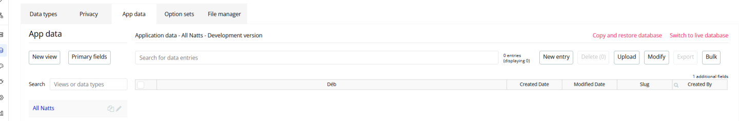

I’m working on back-end workflows for my future use case. I want to send data from Make to Bubble. My data is sent correctly to Bubble, I recover it. I do a Data detect in my back end workflow, and get the number “29”. Then, I want to send it to the database, but the 29 doesn’t make it :frowning_with_open_mouth: I don’t see what I missed so that the 29 doesn’t register in the DB :frowning_with_open_mouth: . Thanks in advance

Here is bubble :

As this workflow will be triggered by a POST from Make.com, you need to check the checkbox “This workflow can be run without authentication”.

Thank you very much ! I have check “This workflow can be run without authentication”., now it runs ! :slight_smile:
