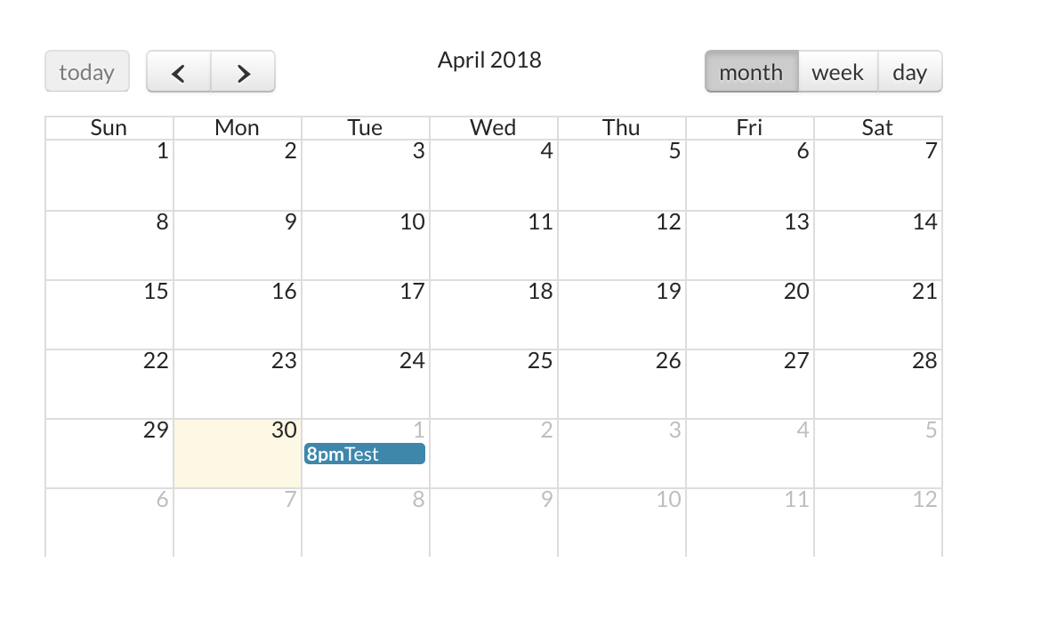

This way the calendar will display an 8pm event like this:

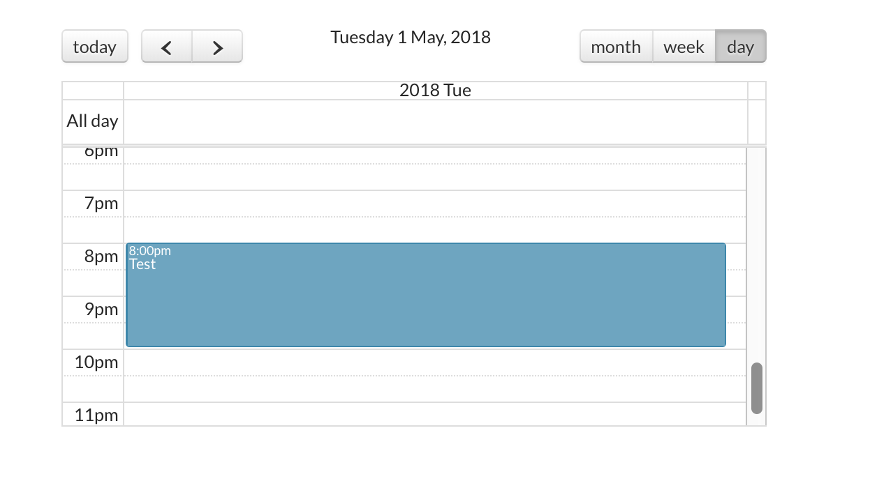

And in the Day view, the hours will be displayed in AM/PM on the left side as well:
ahhhh thank you!! It worked!
