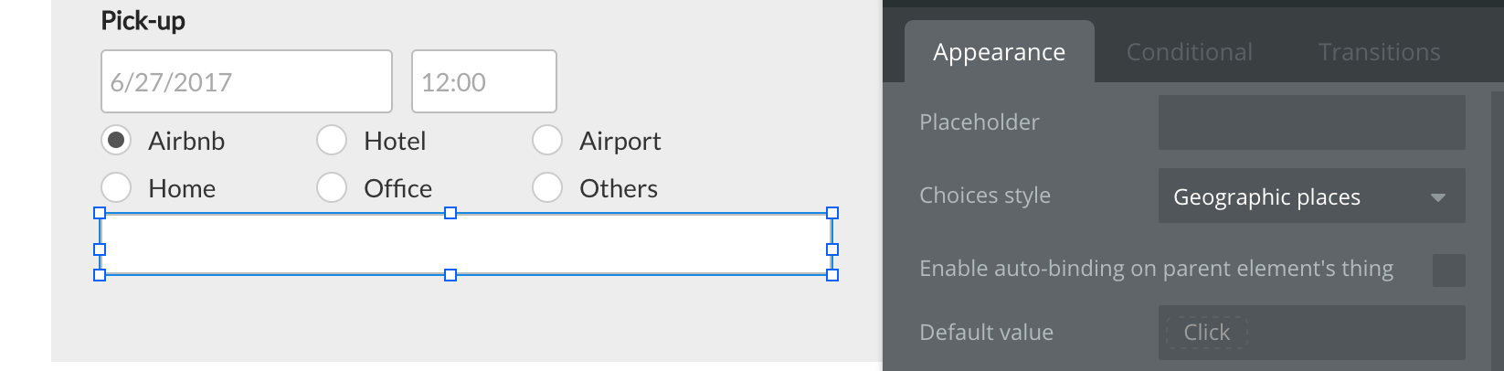

Hey @timgrievester
I don’t think you can specify a radius when using the searchbox element, but you can create a similar setup using an input, a repeating group beneath it, and the Google Places API by Bubble. Here is an example of what the repeating group settings could be:
