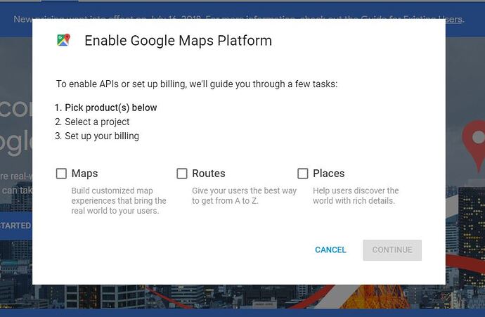

Click get started. (You may need to create a Google Console Account) I had no idea what it was but it is pretty easy to navigate with Youtube videos.

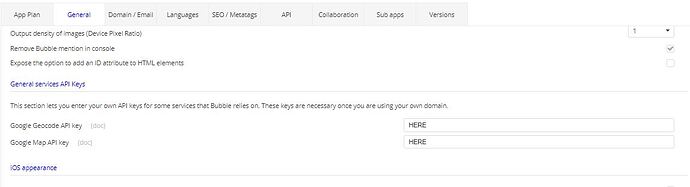

Anyway select all 3 options. And create the API Key. This API key will the be put inside the Settings > General tab in Bubble.
Google will ask to put your billing info in. Go ahead and do it. They will give you a $300 credit to use.
