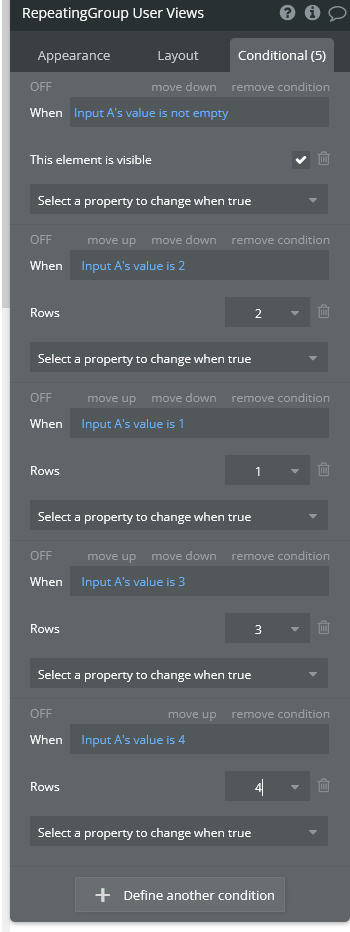

Anyhow, what you want is to use a standard group, and toggle it visible or not based on whatever your input criteria is.
In this example, I have the group showing when the input is not empty, but you can do anything you want to make it visible.
A simple way to test it is to create a silly set of conditions like this.
Good luck!
