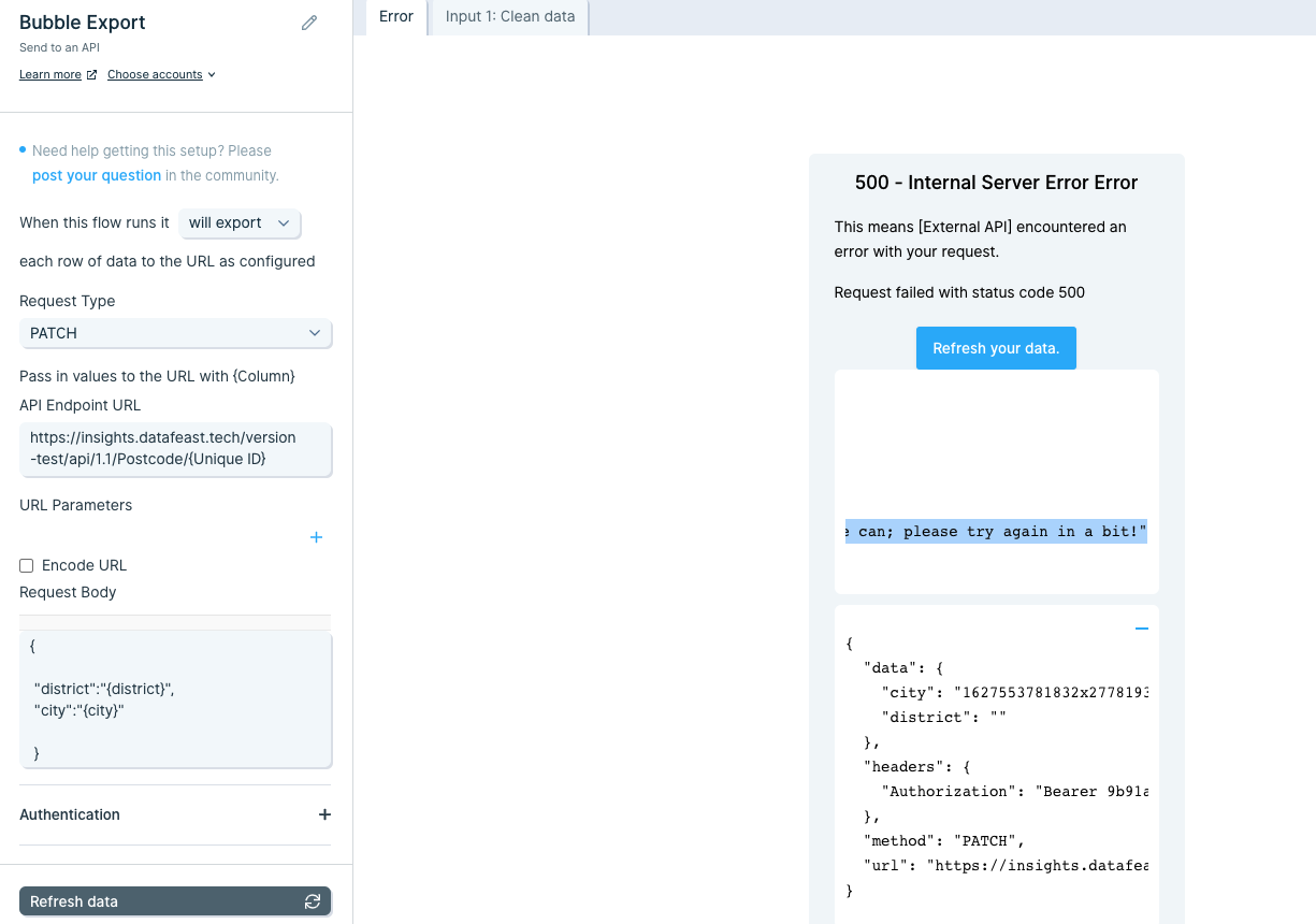

You will find the screenshots of my setup on Parabola and the message error received after run the flow
- parabola set up
- Parabola error message
Also, i added the full error message below
“args”: {
“code”: “1627640007817x355412801545356350”
“error_class”: “UnexpectedError”,
“message”: “Sorry, we ran into a temporary bug and can’t complete your request. We’ll fix it as soon as we can; please try again in a bit!”
“data”: {
“city”: “1627553781832x277819399039627620”,
“district”: “”
“headers”: {
“Authorization”: "Bearer XXXXXXXXXXXXXX
“method”: “PATCH”,
“url”: “https://insights.datafeast.tech/version-test/api/1.1/Postcode/1627554112400x285402435118491400”
Let me know if you see something that is not set up right on Parabola.

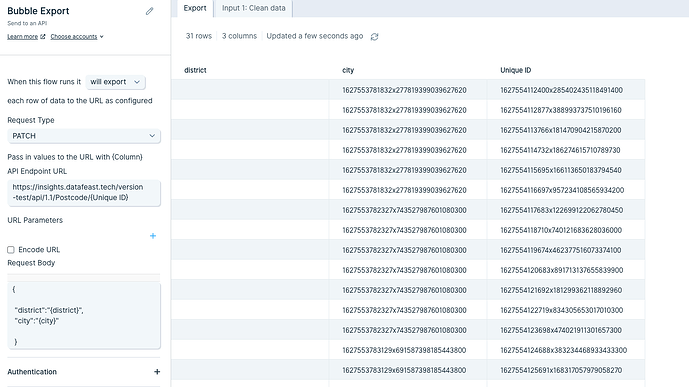

By the way, the fields “district” and “city” are foreign keys (unique id) from other datasets in Bubble. Do you think this might be the cause of the error?
Ah, that’s a good point. Worth testing. Why don’t you copy and paste out your JSON to keep it safe, and try another test - add a dummy column like “test” that’s a text type to both your Bubble table and your CSV, then try to send a dummy value through with just:
"test":"{test}"

Pro-tip : I just won another fight against a Parabola export. Was getting error code 405 with Bubble telling me they only accept POST / GET (I was doing a PATCH from Parabola).
Turns out Parabola went through my Google Sheet list, and at the bottom when it turned into blank rows, it continued trying to send data, so Bubble was throwing a general error like “Hey, no data here, what’s going on??”
I highlighted and deleted all rows below the last row of data, and that solved it.
