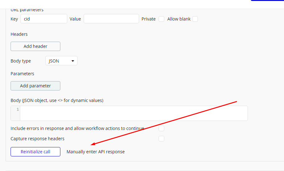

Sure, firstly run your API in postman and get the result of the API like I showed in my original post. Copy all of this.
Go to your API connection and choose the option to Manually enter API’s response
Paste in the content you have just copied.
When you want to refer to this response in a workflow it will be something like
Make changes to User:
  • clientId = Result of Step 1 (Get user info)'s body’s cid:first item

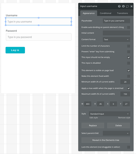

Design a simple login panel with input fields for username and password and a Log-in button.

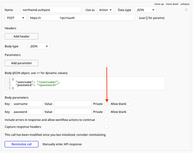

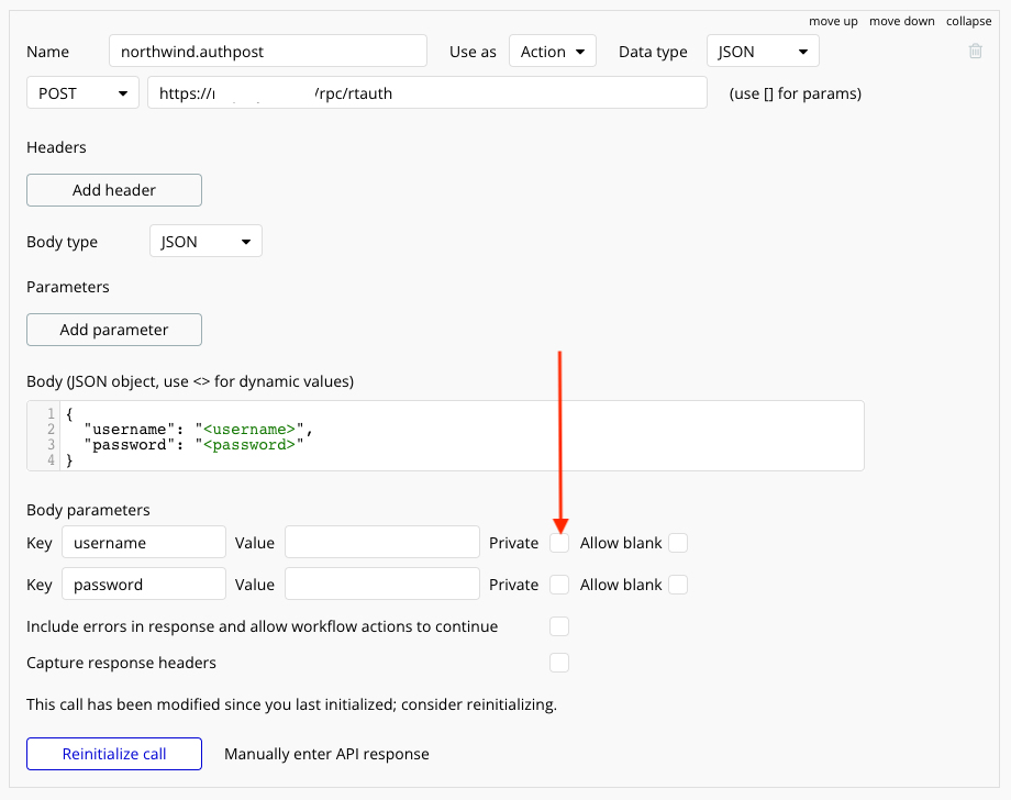

Create a Bubble API Connector to talk to your backend.

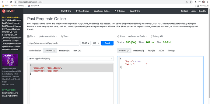

You can use your docs or services like https://reqbin.com/ to find out the correct JSON object data structure of the values returned by the API call.
Fill out the Body field and use <> to mark the dynamic values.
It is important to untick the “Private” boxes - otherwise you are not able to hand over parameters from the login form.
Reinitialize the API to see that everything works.

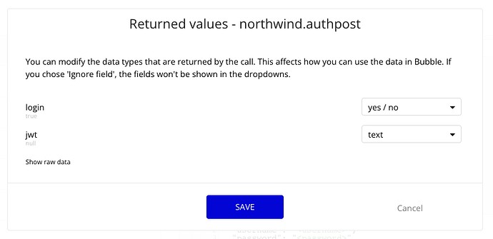

The API call returns:
login as boolean
jwt as text

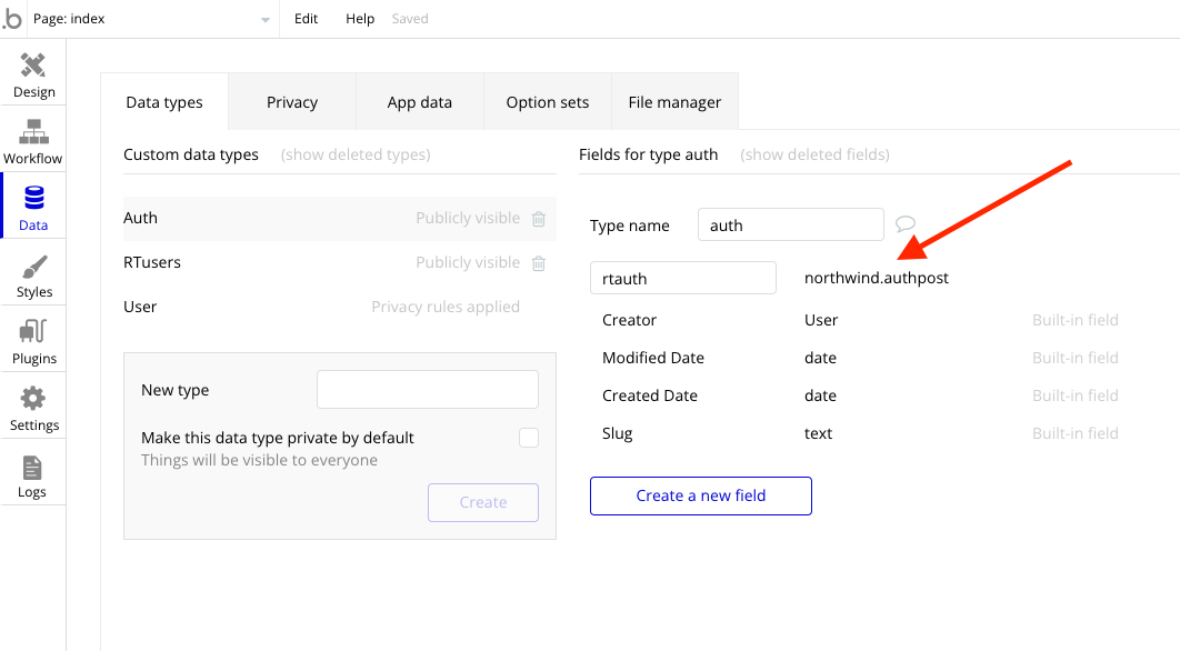

Create two additional field in the User Thing:
login and jwt to store the results of the API call.
Step 5
Create a thing which links the API.

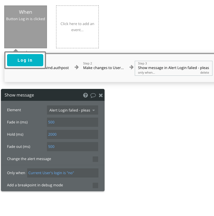

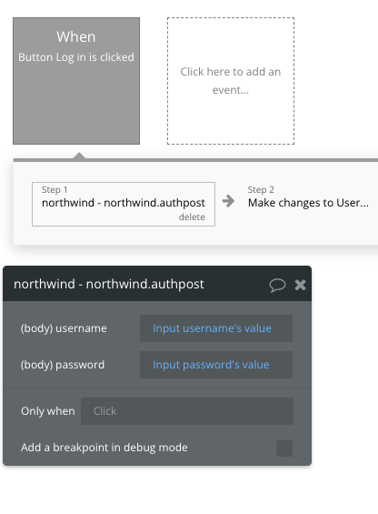

Set up a workflow which handles the Login-Button click event.
Add a plugin action first.
Hand over the username and the password to the API.
Write the results of the API call to the User thing.

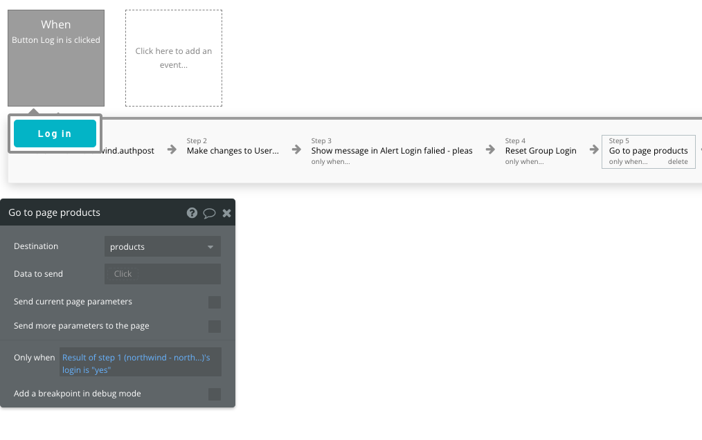

Give feedback if login failed
Jump to the first page of your app, if login was sucessful
