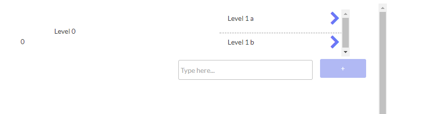

This looks terrible, but it works. Hopefully you get the idea.
So you are only showing two levels each time, and you can drill down using the chevrons.
Yes - brilliant. That’s kinda of what I’m trying to do right now :slight_smile:
