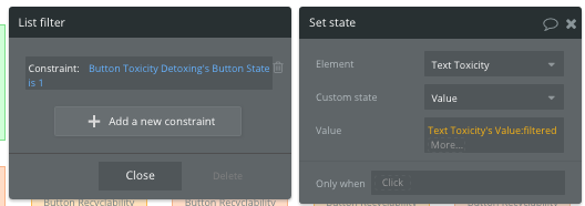

Thank you for your reply, Indeed it does what I would like to achieve but, the issue is that i am not using List, I am using button.
So I tried to apply your technique to my button, but as I don’t have unique id, I’m filtering it using my “button state”.
But it is removing everything in my list.
I can figure out how to set up the constraint to make it work…
Do you have any idea?

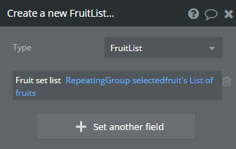

However, could you please help me with one last thing ? I would like to save the final output list in one case of my database when one button “send” is clicked. But I can’t figure out how to set it up.
it would appear like following in the database:
Customer
Name / Pear, Apple/
When the button “send” is clicked
-> Create a new thing
-> Type : Customer
  • add name
  • add ListOfFruits (What should be its type : List of text ? List of Fruits?)
and then, ListOfFruits add …?
I’m lost I tried a few things but it wasn’t sucessfull.
Thank you in advance for your help and your time :slight_smile:
I have added an example of Saving these lists on the link above.
Thank you for your help.
Is there a way to save the FruitList not in numbers but in real Fruit names in the database directly?
