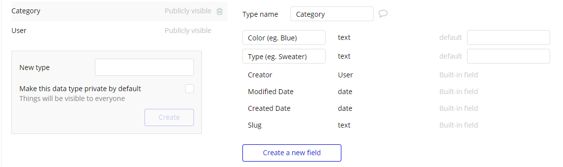

You need to somehow get your elements in the list to be its own DB record with its own unique ID. An example of your new data type:
To create a field that is a list of a data type will look like this:
