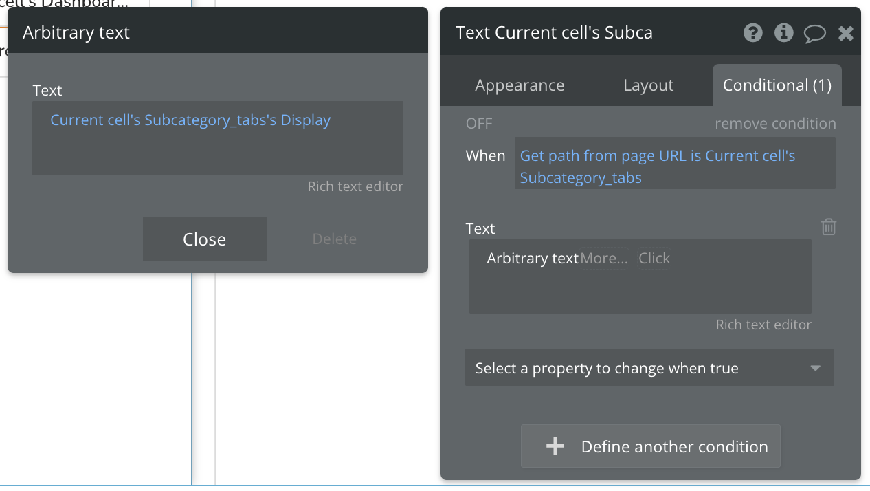

I am trying to make sub menu items under a repeating group using option sets.
I have options set to each main category (Dashboard, Reports, etc). Then, I made additional options sets that have been added as a list of attributes under each main category.
Currently, I am trying to setup the menu so that when clicked, the url determines which page will show up when the user clicks on one of the menu items.
This is the logic when clicking the button:
I am having trouble finding the correct logic for the group of each subcategory. Here is an example screenshot in one:
There are no errors in this but it does not change the url when clicked. Anyone know the correct logic for it?

Based on picture you’ve uploaded, I assume you’re building a single page app.
Try to use arbitrary text, just like this.
Fill the “arbitrary-text” with your sub option’s display, then set the conditional of your group/page/whatever it is to be shown only when get page from page URL :item #2 is "arbitrary-text"
Hope this help cheers

Delete this workflow.
Set the conditional of your “Page-Group” to be shown only when get page from page URL :item #2 is "arbitrary-text" and make sure to choose Path segments as list.
If you wonder why is it :item #2 ?
This is how we define the list’s number.
small-flock3.bubbleapps.i*/version-test/dashboard/reports
dashboard = :item #1
reports = :item #2
If you find this difficult, don’t hesitate to let me know.
Wow it worked! thank you so much, have been trying to figure this out for three days!
