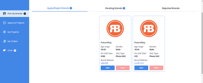

I am stuck in a problem where I want to hide the space of a repeating group cell if the condition matches with that cell.
As you can see the space in red box, I want to hide this space as my condition is matching with the cell which are hidden but there space is still here.
How can I do it?

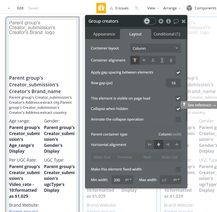

in layout settings check the box for collapse when not visible
@boston85719 it is already checked

Show the screen shot of it checked as well as the screen shot of the conditional you have placed onto the element you are trying to hide.

Screenshot of checked :
Screenshot of condition on cell:

You should have the collapse when hidden checked, the show on page load unchecked and the condition should be set so as to determine when to show…now, that is for when you want an element to be visible or not based on a condition.
In your case, it seems that you are just trying to hide an entire result from a repeating group, not hiding certain elements within an RG cell that display specific data fields of a result, so you likely do just need to figure a way to show only the results that are supposed to be shown via the datasource of the repeating group.
