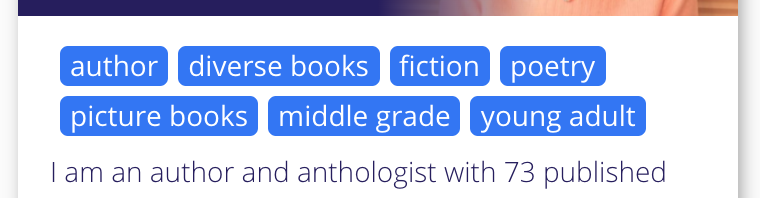

How can I style this:
to this:
I need to adjust each chip’s width to wrap around the text.
Thanks.

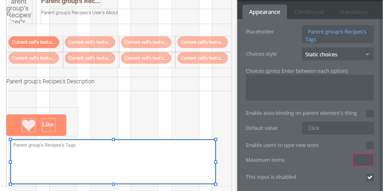

In the element properties pane just check the “This input is disabled” box, and you can display tags like this:
Thanks for coming back. This is what I have:
And this is how it is looking:
I must be doing something wrong!

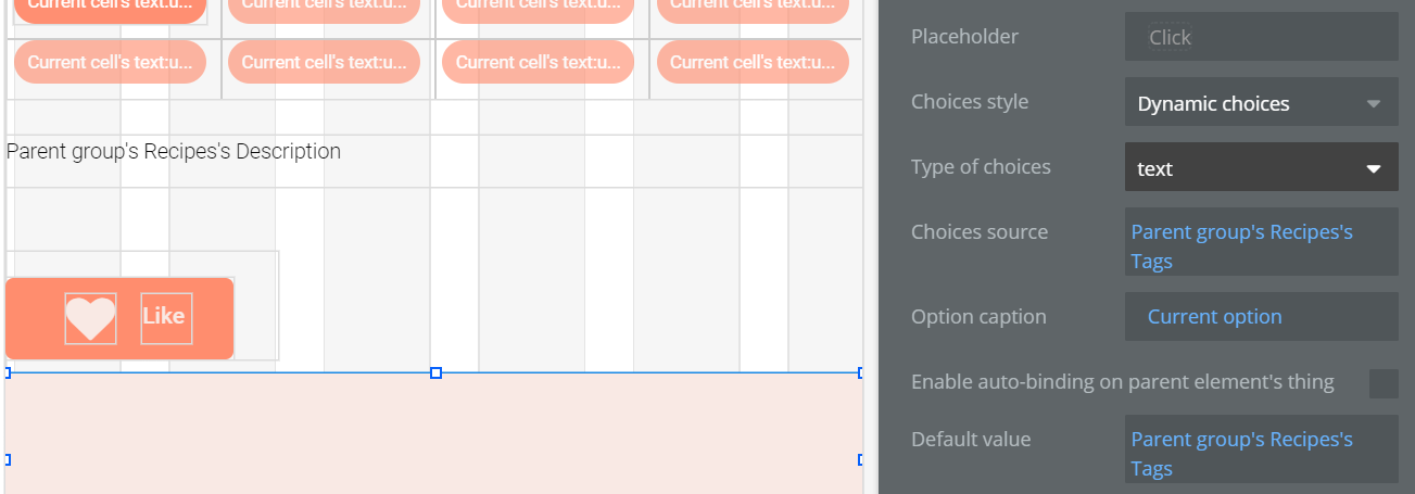

I also tried this and get nothing in the field:
Fill in the “Option caption” section — that’s the label you want to display. The above section the source of the label, but you still need to tell it what field to display. In your case since your source is a text you’ll probably just end up with “Current Option” as the value in the “Option caption” section.
Thanks again.
Had to fill out the Default value as well for it too work!
With some styling here it is:
