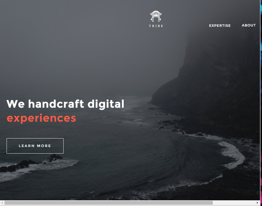

My website is fixed and I want to make it fluid like this one :
http://workwithtribe.co/?utm_source=bubble
Or maybe responsive if that’s possible

You can’t do responsive or fluid layouts – that site is most likely floating elements that make it look somewhat fluid/responsive. There are many posts asking when it will come. This one even has a comment that it’s coming soon from December. Is bubble Responsive?

@NigelG I only answered the OP’s question and explained that the site isn’t fluid. What they did was set their page(s) to “centered”.
They are still using a fixed width of 1100px for their main content area and if you scale your browser to smaller than their width then you will start to cut off the page and get a horizontal scroll bar.
So while @Armand may be able to achieve what the example site is doing, it is not a fluid or responsive layout.

Is it what the OP wanted? We’ll have to wait for @Armand to respond. The subject of the post is “How can I make a fluid website?”.
The answer to that is, you can’t, at least not yet and the site you’re showing as an example is not really fluid.

I centered my web site, and it’s far better like that. But I still have a scroll bar at the bottom of my page.
How can I get rid of it ?

I don’t see a horizontal scroll unless I make the browser smaller than 980px, if that is what you mean. There is no way to not have that scroll at screens smaller than 980px. We can only keep requesting that Bubble implement fluid/responsive features.
