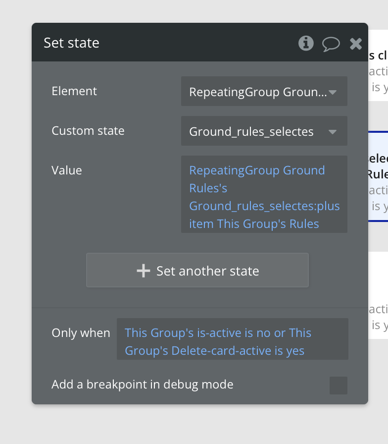

I have purposely chosen to save the information to a custom state instead of directly into the database for UX purposes. I now want to delete an entry on clicking a card in the backend, easy enough to do in the frontend.
But cannot work out how to do this.
I have tried adding a delete thing at the end of the backend and also I have a new backend workflow that focuses on deleting the item that is selected in the backend but nothing works.

On click I set the custom state (list)
On clicking save the backend workflow is scheduled.
Backend workflow: Add to database
Delete backend workflow
Where am I going wrong. BTW adding to the database is fine I just want to remove from the database.

Hi @boston85719 I tried this, this is the very first thing I done and nothing worked. I can delete on the front end no worries, even if I copy and paste the same workflow in the backend nothing works unfortunately,.
