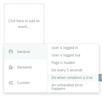

“Make changes to current user” would probably be the best workflow. In the User database table, add a field named “last page”. Make the data type “number”.
Then every time the current user changes pages, set the current user’s “last page” to the number of the current page. The workflow should be “do when condition is true.”

@dbevan covered the gist of saving the user’s place, so depending on what your element setup is like, you can use a custom state or repeating group action to go to the page of that saved value.
