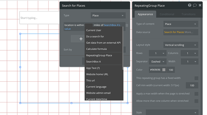

I have a type called Place with 2 fields
LOCATION geographic address
MILES number
and a Search Box field with geographic addresses
In repeated group data source I want to search for all places where “place’s LOCATION is within MILES of Search Box’s value” but MILES field not showing in the drop down.

If you ever find that a certain constraint’s available options are not visible to you or you’ll need something a tad more complex to yield, always take a peek at the :filtered option for lists. A hidden gem in Bubble is the Advanced option for filters which can let you do some pretty crazy things. If you build constraints with Advanced, the terminology switches to use ‘This’ which is another way of saying ‘whatever thing the filter is looking at when it’s filtering’. You could tackle your constraint with an expression such as: This Place’s location distance from SearchBox A’s value <= This Place’s miles.

This is because it needs a number value, and only shows elements or other expressions as what it thinks can give a number. If you include, say, a slider control on the page, it would show up in the picker. Another option is a number field in a thing or custom state.
For flexibility, in addition to :filter that @iamsalar mentioned, you may find it useful to change the data source depending on certain values, by using the conditional tab.
MILES is a number. I will try your suggestion of changing data source by using conditional tab. Thanks @iamsalar and @mishav
