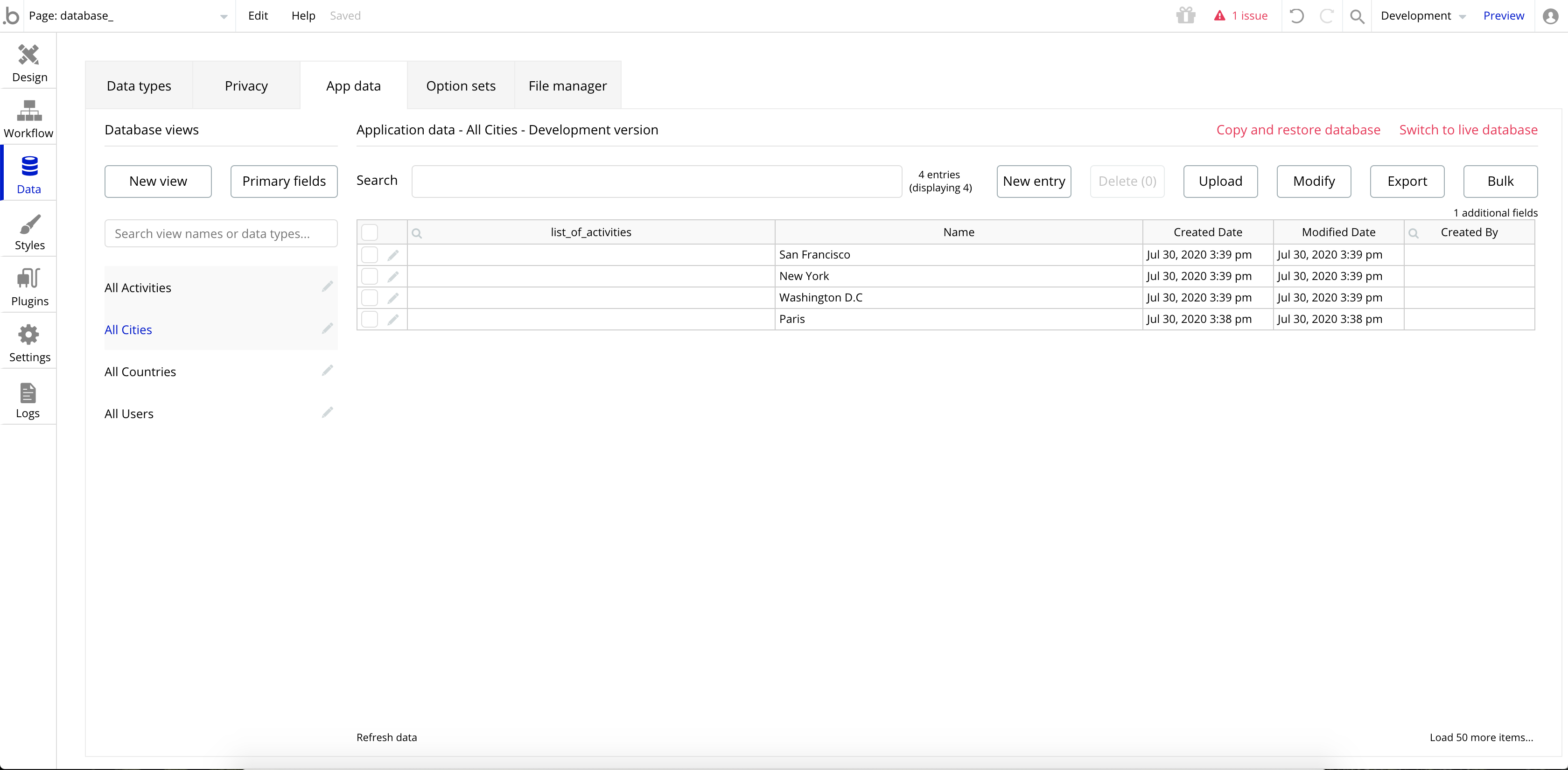

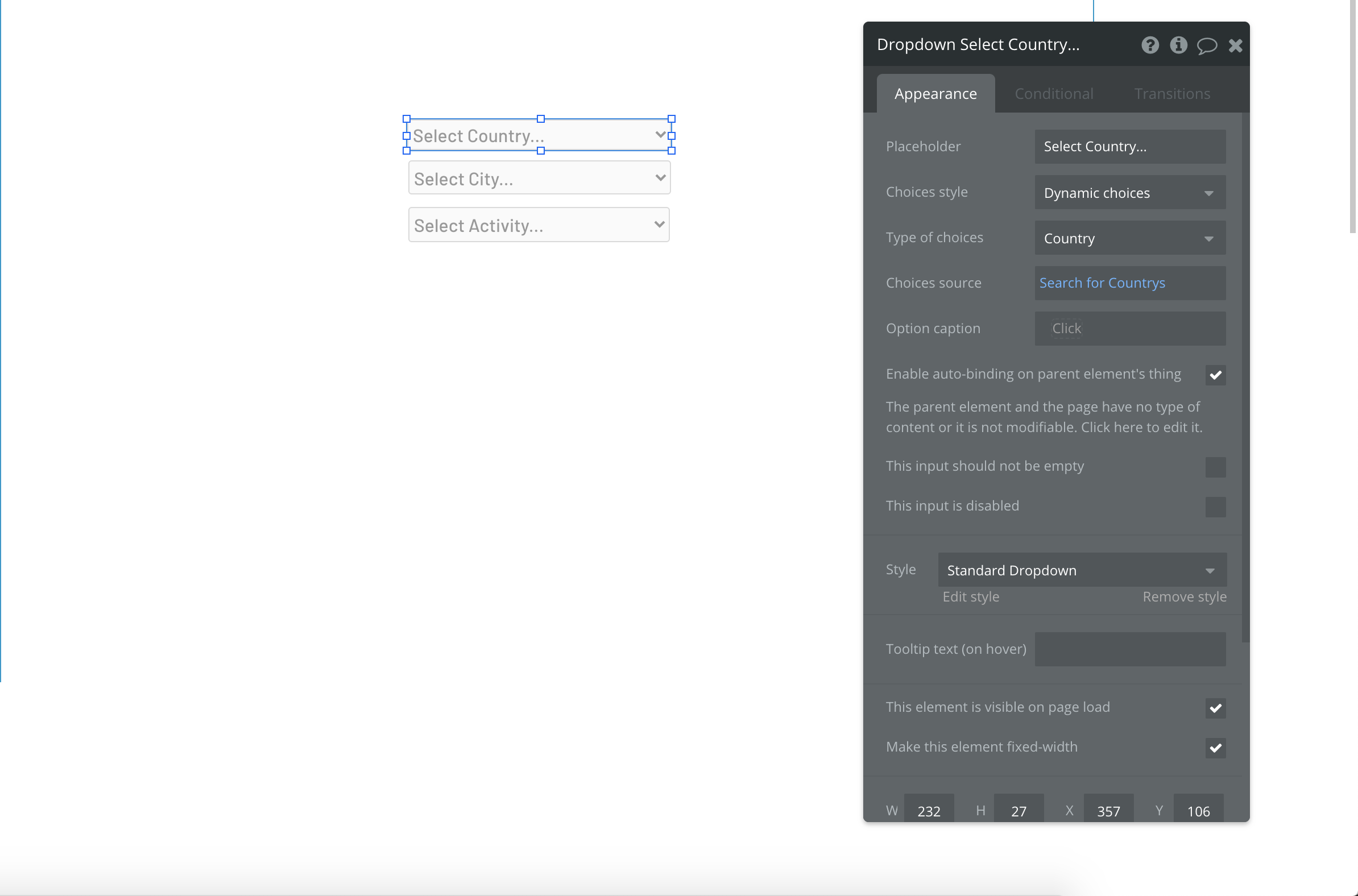

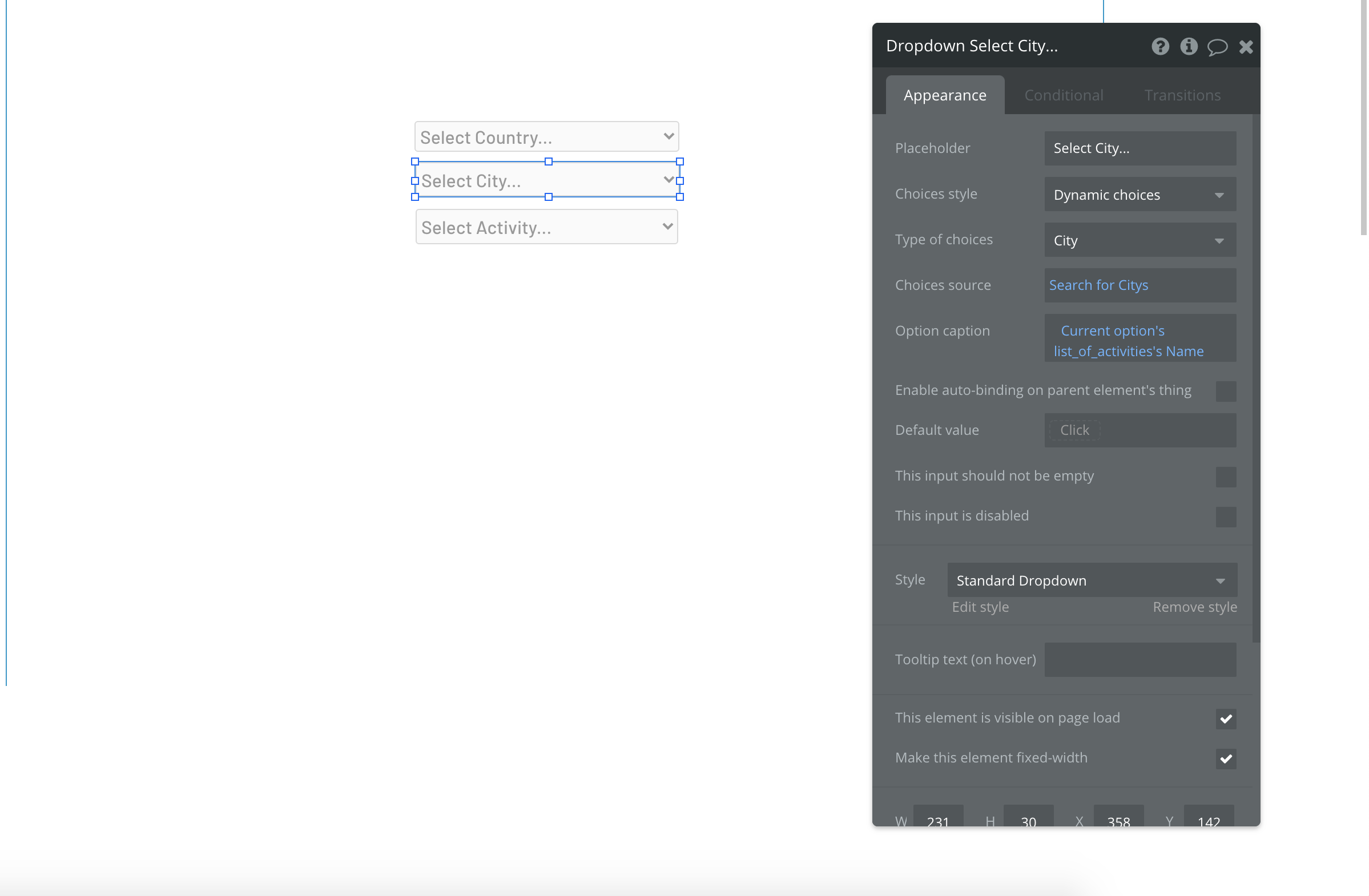

I might be doing something wrong here even though I built the parent-child relationship with my db.
Data :
Dropdown Select Activity :
Upon clicking the dropdown, it’s not triggering the other dropdown to be selected accordingly.
Choosing USA doesn’t bring SF, New York and Washington. It does bring all of them to be selected.
