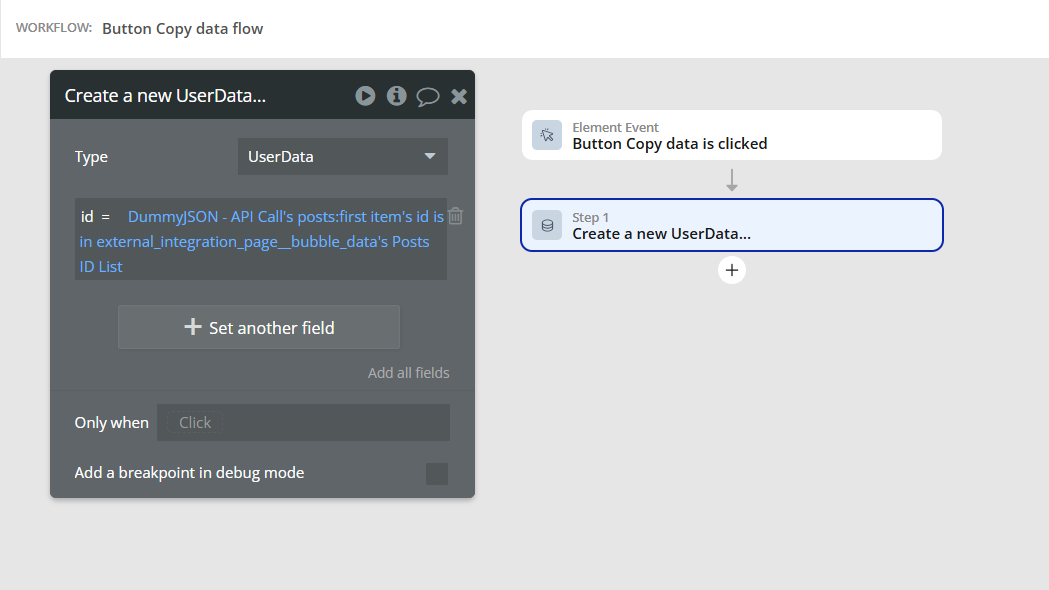

Here I’m trying to create a new thing and populate the ID field with the value that is in the “field” of the external API - ID, and matches any of the values in the Custom State List (I also tried to specify the first value from the Custom State List). But for some reason my expression doesn’t work, it always takes only the first value of the ID from the List API, but not what I want to take from the Castom State List.
That is, for example, in the Castom State List there is a value 2, and I want the ID field to be filled with the value 2 (but it is fundamental to take this number from the ID field of the external API, because I plan to fill the fields of other values from the external API by this comparison.
I found a solution (possibly the right one, but not sure) by using the :filtered option
