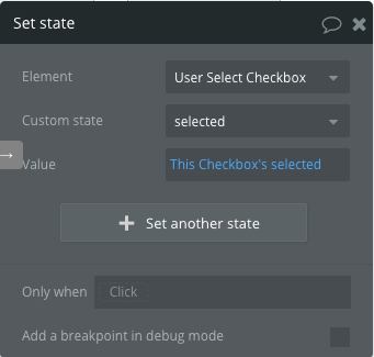

I’ve tried adding the user’s to the list but it doesn’t seem to be working. See anything else I’m missing?
Screenshot 2020-05-24 16.55.14
Screenshot 2020-05-24 16.55.29
Team Member add list [and then your custom state]… (not the RG).
Lets walk through whats happening here:
You’re using the custom state to hold the selected users as a list, like an array from the old world.
Then when the user clicks save, you can save the list/array to the record.
Here’s another useful tip:
While you are going through the development and trouble shooting, it’s always useful to display your elements on the screen that are doing your work for you in the background… in this case the custom state “selected”.
If you put that within a text element and have set the plus/minus steps correctly, you should see the users getting added and removed from the custom state.
