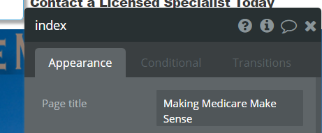

I really appreciate the replies, however, it doesn’t look like these solve the issue. I am on the paid plan, so copying the app isn’t an option. Under the domain/email screen my URL is the web address, which shows up fine. It’s the actual title of the homepage that will not change. The actual index page name has already been changed. See attached, but the page itself when shown in search results always comes up as the old dummy name “T65” that the app was created under.
index
I’m assuming you pushed the Page title change to the “Live” environment, right? Offhand it looks like you have it setup correctly (I have apps setup similarly and they work as expected). Not sure if it’s a google thing where they have T65 cached in their algorithms. Did you recently (last 24hrs) make this change?
Thank you. Yes, it’s been updated on live for about a week. I just noticed the dummy title when it came up on a search a week ago, and have been endeavoring to fix it since. Maybe I just need to be patient and let Google do its thing.

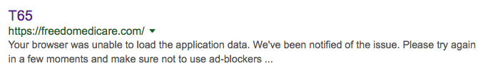

When I try looking at your website via Google, it includes the snippet below.
Based on the snippet, I’d say it’s a caching issue. And the cached information is based on the application not being able to load. Perhaps you had added the domain but not yet pushed to live? Can’t think of why you may see that error (unless Google happened to crawl your site when Bubble had an outage, which seems fairly unlikely).
57%20PM
That was actually because the sitemap was not visible in the SEO settings, so Google wasn’t able to crawl it. I noticed that was switched off just today. Oh, the little things we overlook.

I’m my case, it was my own fault. I overlooked the expose sitemap setting in the SEO settings. That fixed the issue.
