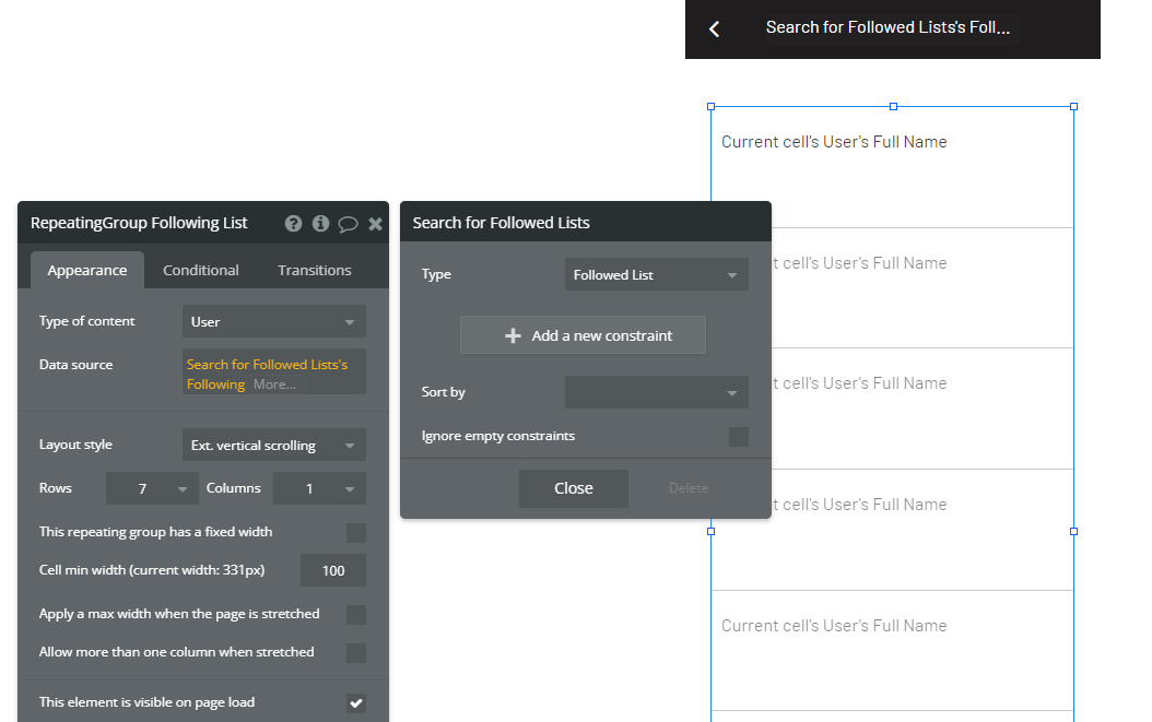

Hey @hannah.svihus, I’m having the same issue and I’ve been attempting different approaches in the forum. I’m really curious as to how you got the follower system figured out. Please help.
@edengaitor17 I’d probably create a data type called “Follows” and give the data type 2 fields, both type=user. I’d have one field called “Follower” and another called “Followee” or “Followed”. I think this approach is better than maintaining two long lists per user.
In doing that I get confused and stuck trying to do 3 things:
  1. Display all the user’s followers in a repeating group
  2. Display all the user’s following in a repeating group
  3. Create conditionals to hide and show follow and unfollow buttons based on whether the current user is already following the current page user or not.
I’m also unsure as to whether I have to create an association between the user data type and the followed details data type as they seem to be separate data types.
Below are some images that outlines what I’ve done so far, and perhaps you can let me know if I’ve done everything correctly or whether I need to make some changes.
Also where I am stuck now is with creating a notification that notifies users when someone follows them.
IMAGE #1 Create a Followed List Data Type
followed list data type
IMAGE #2 Create a Follow Button Workflow
IMAGE #3 Create an Unfollow Button Workflow
unfollow button workflow
IMAGE #4 Create a Condition to make Follow Button visible
IMAGE #5 Create a Condition to make Unfollow Button visible
IMAGE #6 Create a page to display a list of Followers in a Repeating Group
IMAGE #7 Create a page to display a list of Following in a Repeating Group

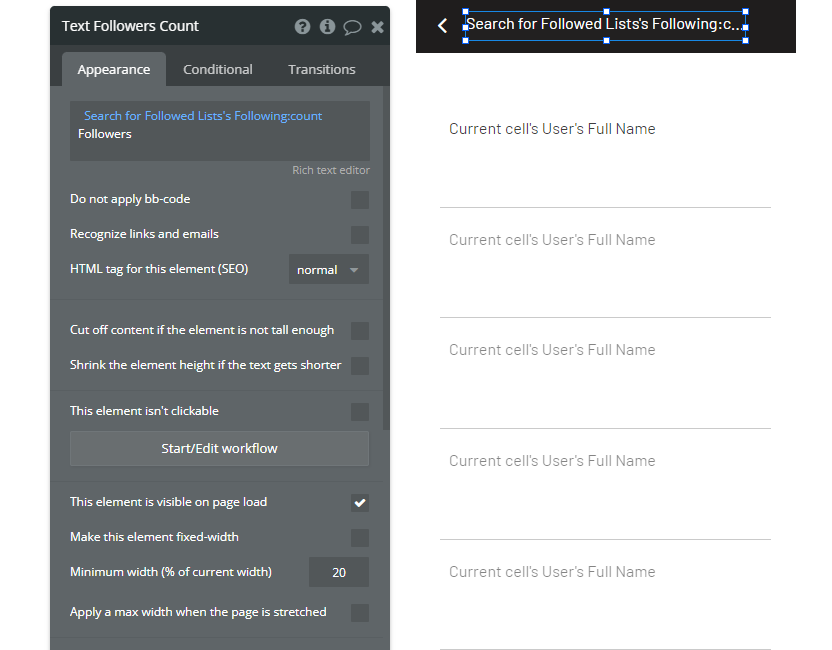

IMAGE #8 Display Number (Count) of Followers
IMAGE #9 Display Number (Count) of Following

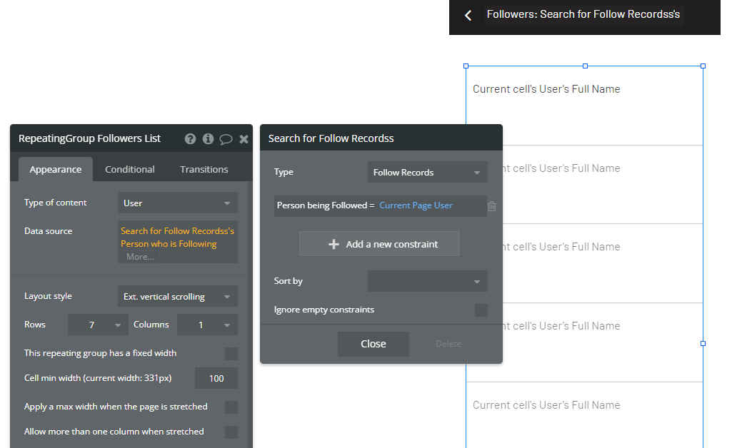

(I’m assuming you a have page user and you want to display all the followers of the page user)
Data Type = User
Data Source = Do a search for Follow Records, conditions (person being Followed = current page user) Person who is following

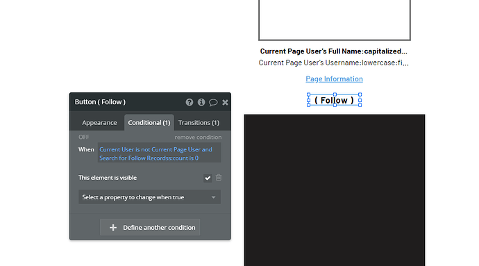

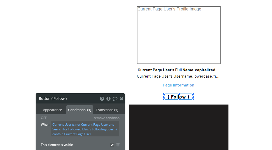

Follow Button
I’d make the default state of the button unclickable. Then, I’d add these two conditions:
1 - When Do a search for Follow Records, conditions(Person being Followed = current page user | Person who is following = Current User) count = 0
This element is clickable (checked)
2 - When Do a search for Follow Records, conditions(Person being Followed = current page user | Person who is following is Current User) First Item is not empty
Text = Following
(Or hide the button if that’s what you prefer)
Based on this information see if you’re able to handle the unfollow button as well. If you get stuck, I can help you out. Let me know how this goes then we can tackle notifications
Hello @alex.esposito.1108, so far everthing seems to be working. Thank you very much! :grinning_face_with_smiling_eyes:
Here is a display of how I carried out your suggestions. Maybe you can let me know if I truly did as was intended.
IMAGE A: Follow Record Data Type
follow records data type image
IMAGE B: Follow Button Workflow
IMAGE C: Unfollow Button Workflow
IMAGE D: Page to list Followers in a Repeating Group
IMAGE E: Page to list Following in a Repeating Group
IMAGE F: Follow Button Condition
IMAGE G: Unfollow Button Condition
@edengaitor17 that looks good. The first image doesn’t show the data type (it’s just a repeat of the second image) but it seems like you’ve got it set up properly.

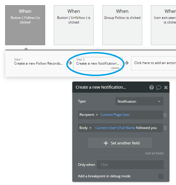

As it relates to Notifications, here’s an outline portraying what I’ve done so far and where I’m stuck:
IMAGE #1 Notification Data Type
IMAGE #2 Follow Button Workflow that creates a new notification in step 2
IMAGE #3 Repeating Group to display list of Notification (Yes, I do have a dedicated page to display notifications)
IMAGE #4 Notification Button Condition to turn blue when there are new notifications that are not yet seen
(This is where I get stuck…)
IMAGE #5 Notification Button Workflow to change ‘seen’ status to ‘no’ when clicked and to navigate to the notifications page
(This is also where I get stuck)

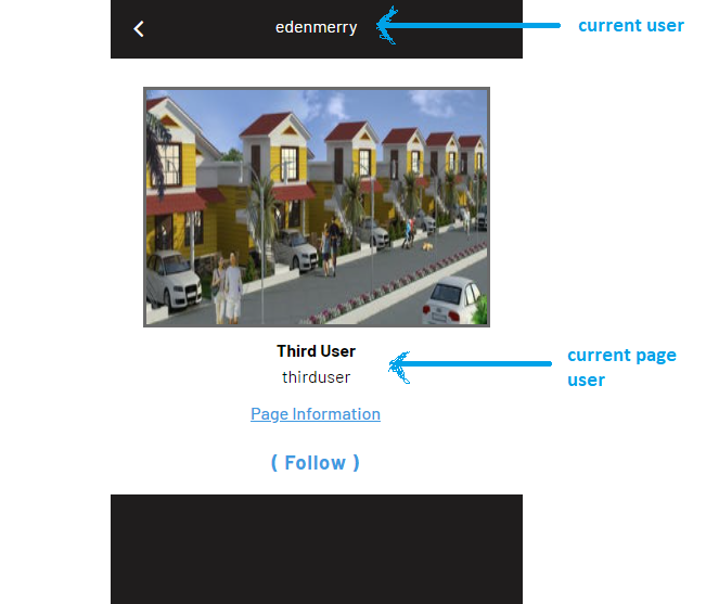

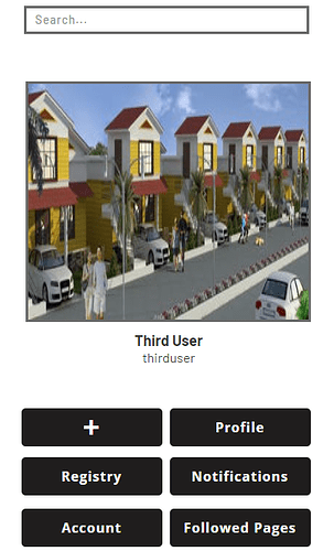

USERFLOW:
I was having difficulty uploading a video of user flow in the right format, however I’ll do my best with images to demonstrate the user flow.
IMAGE A: Current User following Current Page User (Third Test User) to trigger notification
IMAGE B: I run the application as the Third Test User
IMAGE C: I had clicked on notification button to go to notification page and see followed notification
@edengaitor17 there are two different general approaches you can take with this. You can either track the seen/unseen status on a per notification basis (as you’re trying to do now), or you can just track it on the user record.
For example, on the user record you can have a yes/no field to track if the user has new notifications. Every time you create a new notification you can update that field on the user record and every time the user visits the notification page you can uncheck that field. On the notification page you can also have a workflow run every 5 seconds to uncheck the field on the user record in case a new notification comes in while they’re already viewing the page. The downside to this is you won’t be able to inform the user of how many new notifications they have, and if you want to highlight each row of the notification RG depending on it’s seen/unseen status (the way fb does) that won’t be possible either. What are your thought on this?
If you want to keep with the current approach you have, in image 4 the expression you’re looking for is Search for Notifications (same constraints as you have now):first item is not empty
For Image 5, the function of the button should be only to navigate to the page. Don’t do anything to the notifications. Then, on the notifications page you can have a workflow to update the notifications when the page is loaded and also run another workflow every 5 seconds in case a new notification comes in while the user is already viewing the page.
BTW, if you want to track info per notification, you could also think about creating an option set to track the type of notification it is…for example, follow, message, like, post, etc.
