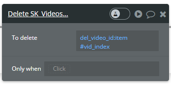

I am having some problems in setting up a recursive workflow at my end with no luck. I will explain as below:-
I have 2 databases
  1. SK_Video
  1. SK_Video_Archives
So what I want to do is to take Video_id_Archive data from SK_Video_Archives database and match that with Video_id_current in the SK_Video database. If a match is found in SK_Video I want to delete that record from SK_Video.
In order to achieve this I have following workflows:-
Step 1
Step 2
Step 3
Step 4
Step 5
Step 6
By running these workflows nothing is happening.
I would be obliged if you great bubblers could help me as to where I am going wrong.
Hope to hear back.
Thanks
Vijay Zutshi
Schedule it on a list, then inside each workflow, search for the matching ID, and delete it.
