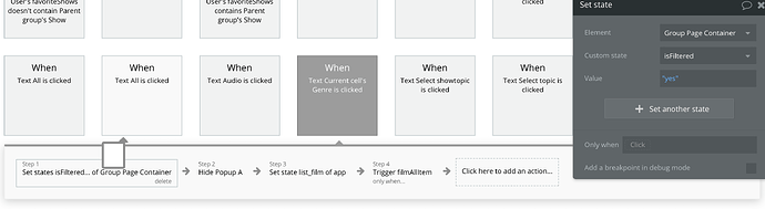

@blurapps got it to work by using the state isfiltered workflow. Thank you!
The only issue I have remaining is that the filtered results RG keep showing on the page even after I click around to other groups. I tried adding the condition isFiltered : “no” for hiding the element but it is still showing on the page.
How would I go about restricting the RG group to only show once the page has been filtered?
I’m guessing I have to figure out how to reset the custom state when the user is opening a new group or clicks on something outside the filtered RG?
Any advice would be much appreciated!
Uncheck the ‘this element is visible on page load’ property in the ‘appearance’ options of the RG.
This will keep it invisible by default unless the condition arises that makes it visible

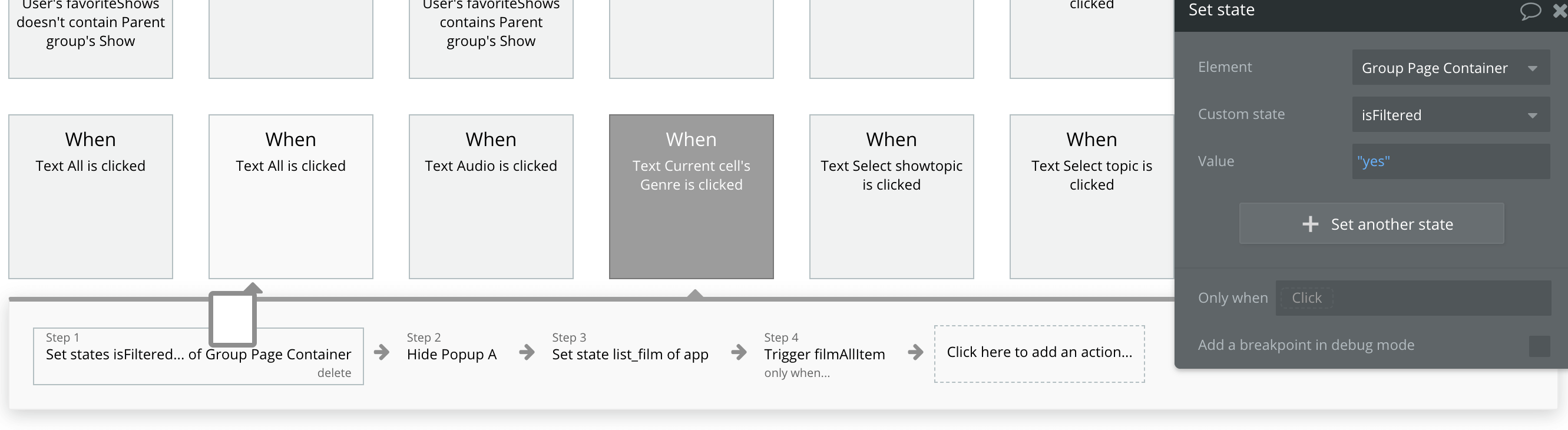

@blurapps thank you for the suggestion, tried that with no luck…is it something I’m missing in the workflows? I just don’t where to put the rule “isnotfiltered” and how to trigger it.
OK
Looks like you’ve set the workflow to set isFiltered to “yes” but there’s nothing that sets isFiltered to “no”
You can do this:
in the workflow that runs when filters are selected and unselected, add an action with a condition:
when none of the filters are active
And make it set isFiltered to “no”
