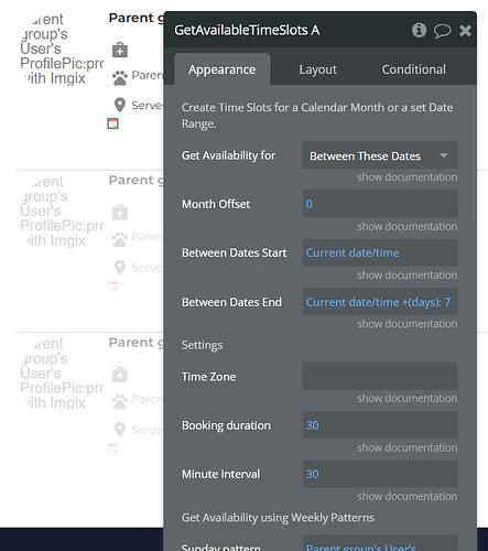

I have a repeating group of Users and I need to filter them by their availability dates. I’m using TopCal plugin which gets the available dates but I can’t pull/filter the dates from the initial repeating group search. I have to pull up the User’s dates from an element that goes in the cell of the repeating group.
How do I filter an item out of a repeating group? I can use a conditional (see below) to show whether it’s visible or not but that just leaves a blank space in the repeating group. I want that row cleared

I’m having trouble figuring out how to set anything on the repeating group. The problem is that each user in the repeating group needs an element “GetAvailableTimeSlots” that has to be placed into the cell of the repeating group in order to get the availability times, like below. I think that is keeping me from filtering anything until after the repeating group is already produced
