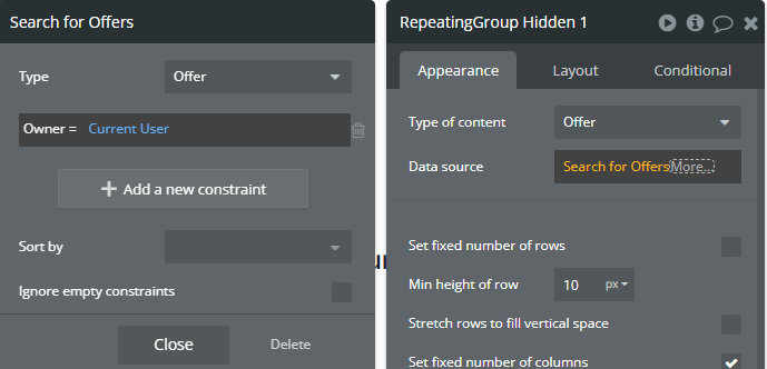

Create two hidden repeating groups on the page (to retrieve the data from your two tables), constrained to return only the rows you need (for example, “From User” = Current User and any other constraints):
Elements Tree on page:

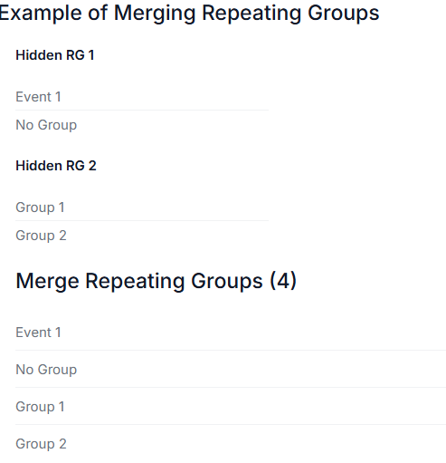

The third repeating group would be visible to display the data the users require. The Type of content would be “Text”, and the datasource would be Hidden Repeating Group 1’s [field you want] (formatted as text if required) merged with Repeating Group 2 [field you want]
The result (with the hidden tables showing for testing purposes):
