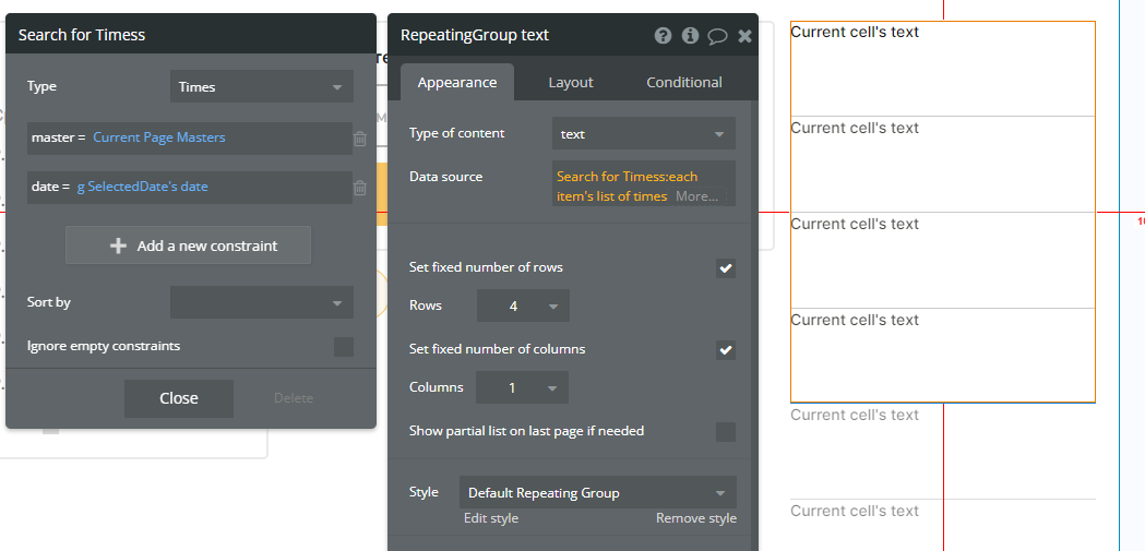

Hi all. Can you tell me how I can display the contents of a list from a database in a repeating group? Right now I have all the contents of the list displayed in one line. I need each individual item, to be displayed on a separate line. Thank you

You could use another (nested) repeating group, instead of a text element.
It didn’t work. I made a repeating group, specified the data source. In that group, I made another one with the text type and also specified the data source. However, all of the entries in the list are still displayed on one line.
RG1
nested repeating group
I think you need to take a look at your database structure here… something seems to be wrong.
What is the ‘List of times’ on the Times datatype?
I have a list of time slots for each of the dates. These slots are written in the time list field with the type text. I need to be able to delete or edit these time slots, so they need to be in separate cells.
Are the ‘list of times’ entries definitely a list of texts, and not just a single text? (it’s impossible to tell just from the screenshot)
I could be wrong, but it looks like one text, right?
Yes, exactly… so that’s the issue…
This is odd, because I take this data to write from the custom state, which is a list. Why is everything written to the database in one text?
Add to custom state
Add to database
You’re adding a single thing instead of a list…
Use ‘Add List’ instead of ‘Add’
Thank you so much!
