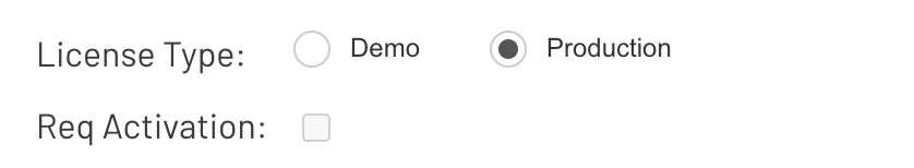

I have a simple UI that has a radio button and a checkbox.
I want to set the check to Checked and disable the checkbox if the “Production” radio button is selected.
This is what it looks like

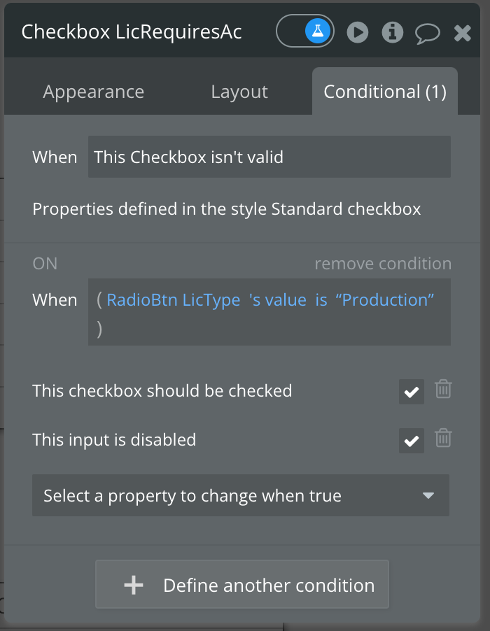

Using the Conditional tab on the properties, I can disable the Checkbox but I cannot find out how to set the Checkbox to “Checked”
Here “Production” is not selected and checkbox is enabled
and here “Production” is selected and the checkbox is disabled

Hey mate,
Honestly, I find checkboxes really annoying to use because of this issue, so I completely understand your frustration. The property “This checkbox should be checked” doesn’t assign the value “yes” to the checkbox, instead, it means that any workflow that is reading the value of the checkbox will not run unless the checkbox is ticked. This is useful for situations where for example, a person needs to agree to the terms and conditions of a website - and you don’t want them to continue until they have clicked that checkbox.
