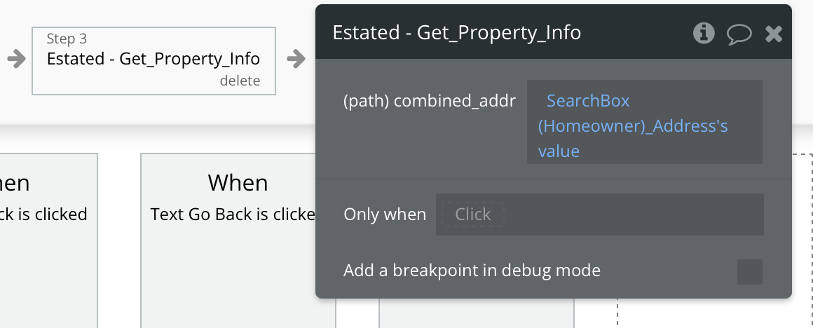

I recently integrated Estated into an app. I found it to work just fine with the results of a searchbox. Is that not working for you? Here’s how I formatted the address for the API call:

I never even touched the sandbox because I got it running with just a few of the free calls. Can you create a new account for yourself to test it outside of the sandbox with your free calls?
I prefer not to create keys and stuff for client apps, but this looks like one of those situations where I’ll have to. Estated doesnt seem to allow you to create new API keys/reset the calls.
Thanks for the input, you helped piece it together.
