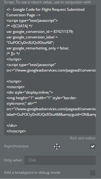

I’m trying to use the adwords conversion script inside of the toolbox but it’s not firing on action… it is not registering inside of Google Adwords.

the <div> is an html element (so not javascript). That code, as is, looks like it’s meant to physically reside on the page instead of being triggered by, say, a workflow.
Any way to get a version of the code that only has javascript? If so, try that.
If not, then perhaps try just putting that code in an HTML element on the page and have it shown on page load (could be 1px by 1px so it’s not really visible to the user). And, see if that works.

Okay. I understand. Have some theories on what’s going on. I suspect the solution, then, is to run this script in Toolbox (as you have tried). One change though - remove all of the code starting with <noscript> and everything below that.
This way, it’s just javascript. Toolbox should run it then. And, that bottom part seems to be purely visual (e.g., HTML) which you don’t need since you’re triggering the JS yourself and not displaying the HTML on the front-end.

That doesn’t seem to work still for some reason.
I’ve used the on-click google adwords conversion tracking script (removed the onclick part) and placed it inside of a Toolbox action.
Is there something I’m missing to get this to work?
Is there any way we can get this working some how using the toolbox?
You can use the PlugBubble plugin. In page load run a custom code block with your code in it making sure to do away with script tags. This will only fire the script when the action is run and does not stay hidden on the page because its an action without an element.
Do i need to remove the when using the toolbox plugin and firing this script on action?
