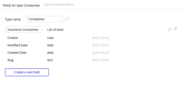

I have made my Coverage element a List as you suggested but still it shows this…

Insurance companies is a list

I didn’t get that exactly but, isn’t this (Insurance Companies) a field in type (Comapnies)
Yes… your Insurance Companies field on your Companies datatype is a list (a list of ‘texts’ for some reason, so I’m not too sure what that’s for anyway).

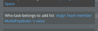

Here is how inserated the data from a multi dropdown
Screenshot 2023-06-16 at 08.38.10
In stead of equal chose “add list” and then in your case it would bee multidropdown insurance companies
