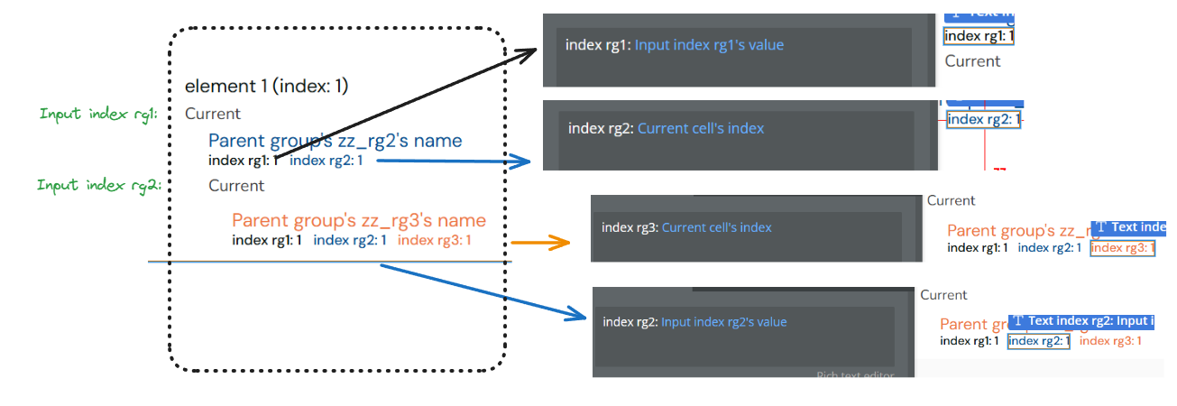

To achieve the desired behavior, you can use what I call a “ghost input”. In each ID, you will add an input and use this element as a reference to get the current_index of the parent ID.
I created this image here to show the example I created more clearly. I separated each ID by color to make it easier to understand.
Here I show the result I had in Bubble by placing the 3 repeater groups
Here is the element tree
The rectangle marked with dotted lines marks the RG nesting that I set up in Bubble for this example. I used the arrows to show the value of each of the inputs based on colors.
Let me know if I was able to explain your question with this example. If not, feel free to ask and I can help you.
